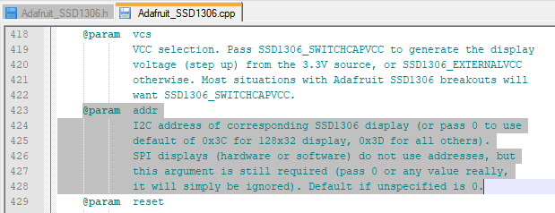

Now, I have the display working properly in I2C with the library "Adafruit_SSD1306 library". David_prentice is right, first you need to remove R17 and put 0R in R13 and R15. About CS pin, the display works if you put to GND or not, both is correct, for example I put 0R in R18 it's the same that CS pin to GND, and it's working perfectly. About RES pin needs connect to the Arduino output pin, and you can put one resistor of 10k pull-up to 5Vcc (I did). About DC pin is the adress of display in the bus I2C, in this case if you use "Adafruit_SSD1306 library", you need to a put pull-up of 10K to 5Vcc, because if:
DC connect to GND, adress is 0x3C
DC connect to 5Vcc, adress is 0x3D
The "Adafruit_SSD1306 library" default use 0x3C for 128x32 display and 0x3D for all others, then we use de 0x3D because the display is 128x64.
Summary if you use this display in I2C and "Adafruit_SSD1306 library":
-R17 = Remove
-R13 = 0R
-R15 = 0R
-R18 = 0R (CS pin to GND)
-RES = connect to Arduino Output pin with a 10K pull-up
-DC = connect a 10K pull-up. (adress=0x3D)
