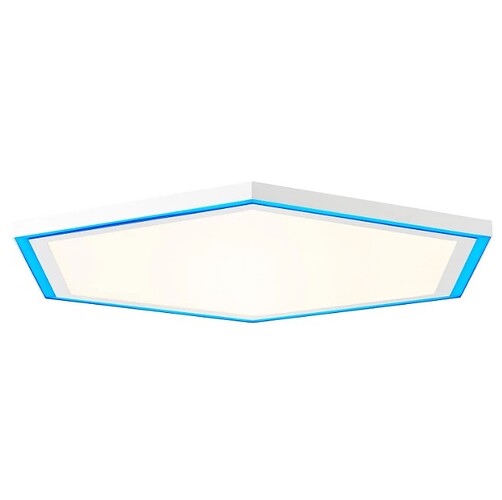

3.3V PWM signal from WS2811 to control other LED driver
I have 8 AEG Evyn LED RGB ceiling lights and they come with a RGB led strip around the light.
These lamps come with a proprietary 2.4GH RF controller with a matching remote control.
This controller is a little PCB that is mounted in the 24V LED driver.
Of course I wanted to get rid of this as soon as possible :wink:
This controller is powered by 12V and sends out 5 times a 3.3V PWM signal to drive CC, CW, R, G and B to the 24V LED driver. I have tested and played with this and in the meantime successfully connected a IKEA Tradfri Zigbee controller, with it's 3.3V PWM signal to the CC CW channels.
It's hanging on my ceiling now and I'm controlling this with Zigbee2MQTT.
Now in my office I want to hang up 8 of these lamps and my idea was to control the RGB LED strip in them with 8 WS2411 modules. Most importantly so I can use WLED with all it's awesome effects but also because it's a one-wired signal.
The reason that I chose the WS2411 is because it says it uses PWM to drive the 3 RGB channels.
