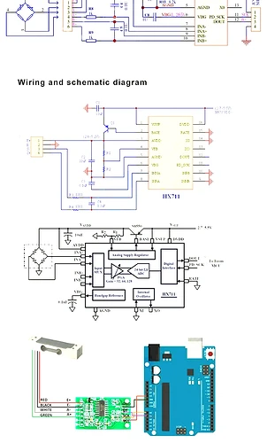

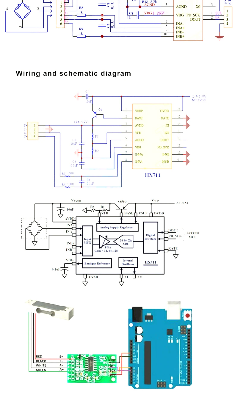

Hi everyone,
I'm new to developing my own projects, and I'm currently building a smart cat toilet that uses 4x 4-wire stain gauges (20kg each) hooked up to an hx711, itself connected to an esp32. I'm essentially building this man's project, and following his instructions: https://makerworld.com/en/models/1343408-smartcat-toilet?from=search#profileId-1384441.
The wires are connected in the way he recommended (wires of all load cells of the same color twisted together), and in the way both him and the aliexpress manufacturer state (red e+, black e-, green a+, white a-).
Initially I soldered a 1000µF 50v capacitor to the gnd and vcc of the hx711 - the maker suggested a 100µf capacitor instead, so I did that. Later I removed the capacitor entirely. In all cases, though, my issue is the same:
no matter how much weight I put on the platform, the readings are very stable. Whether it is 0, 3kg, 5kg, 7.5kg, 10kg, or 20kg, the base readings are 3180-90, and these hardly change at all. In all cases -capacitor wise-, I measured the voltage between the vcc and gnd of the hx711, which is roughly 5.1v. Between e- and e+ it is 4.132v. Strangely, between a- and a+ it is roughly 0,7v, though in my idea, it should be roughly a few millivolts as the signal needs to be amplified. I checked whether these wires were separated, and resistance between a- and a+ is 500ohm, which suggests they are.
I asked the original maker of the project, and he suggested me to use a 100µf capacitor rather than a 1000µf, but no matter whether I use a capacitor or not, I don't seem to get any measurement whatsoever. I can see the beams 'bending' a bit, they are hooked up using screws so there is in fact a cantilever process going on. Any Idea what the issue could be? I can share code, pictures, and videos.
Help is greatly appreciated.

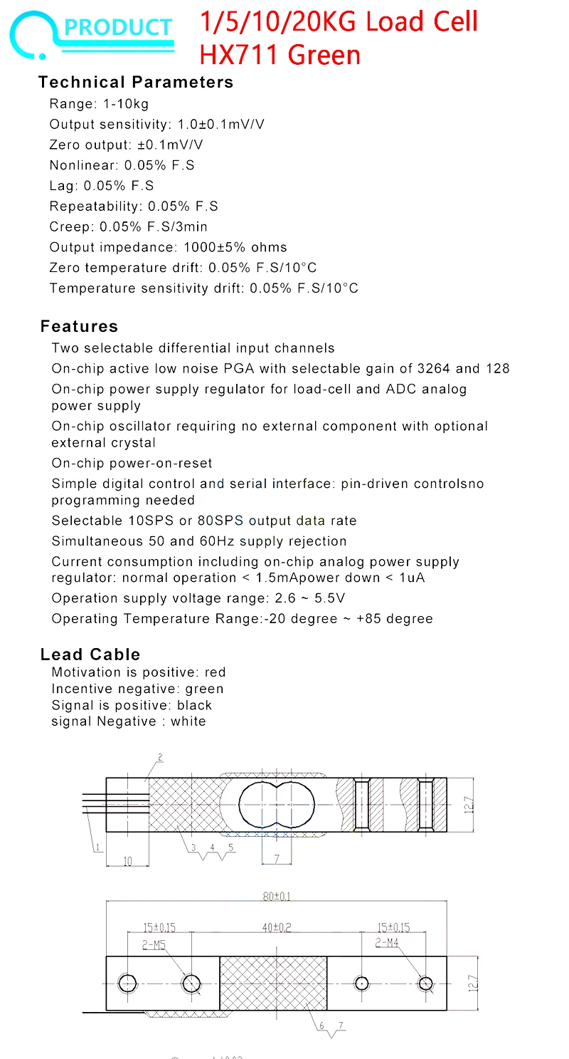

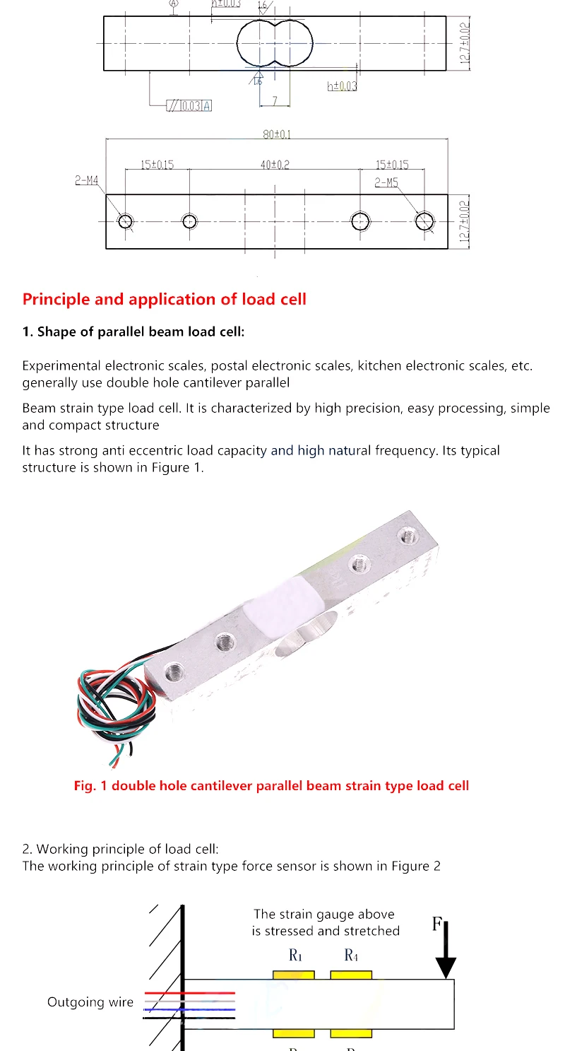

The only difference might be the load cells used...

I have built a scale with an HX711 and always wonder why people think using more than one strain gauge will help. Just use one and follow one of the examples. There are very specific instructions on how to calibrate the gauge. Hint, a reading of 10lbs might be a strain gauge reading of 4,285, it doesn't read out in pounds.

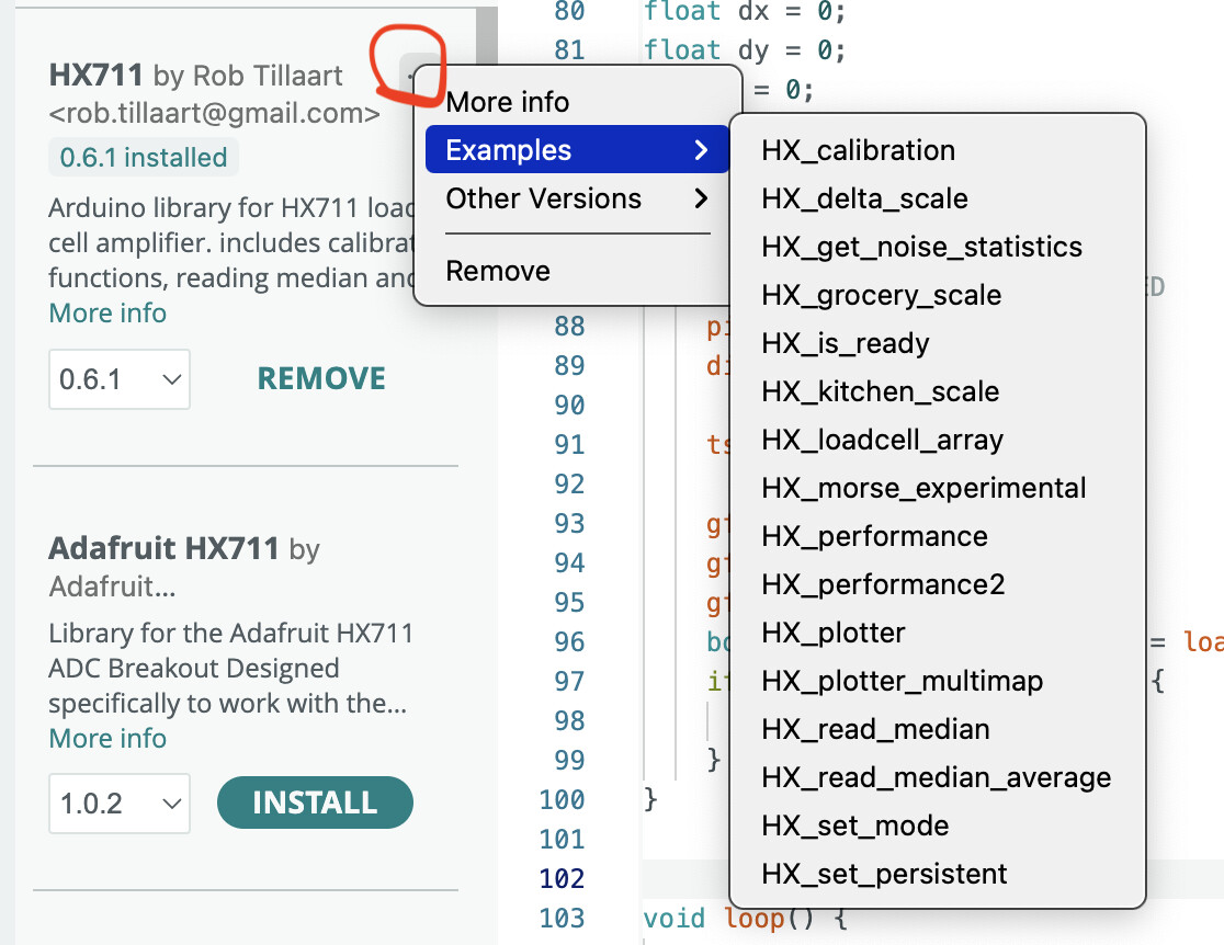

There are several sample sketches, I have attached a screen shot. They are most easily accessed from the ... menu beside the library name.
The maximum input voltage on any ESP GPIO pin is 3.3V, yet this guy has several 5V signals connected including the one from the HX711
You should never connect any signal greater than 3.3V to any ESP GPIO otherwise you risk damaging the ESP
A schematic of you set-up would be nice.
Dear Rob Tillaart, I have in fact read the post, and figured that as my load cells are different, perhaps I'm missing something. Mine are 4-wire load cells. Not 3 wire ones. I'm new to electronics and was simply following the maker world tutorial, as shown by his videos and in his text. I simply do not have all the knowledge to get from a 3 wire load strain to a 4 wire load strain. That is why I create a new post.
Dear Tesla, I know very well that the difference does not read in pounds. I have in fact calibrated the scale using code, and the problem is that no matter how many pounds (or kilos in my case) I place on the scale, there is no difference comapared to the noise in the system. So: values are always roughly 3160-3170. With 10kg, 20kg, 5kg. I do know in fact the raw counts have to be converted to actual measurements. But here is my issue: it doesn't seem to show raw counts. Perhaps there is something wrong with the wiring or the code. But as I actually read the hx711 sensor values I figured at least it turned on and I know the wires of the signal a+ and a- are separated, so I'm not sure why it happens.
According to the specs of the hx711, it should be powered between 2.6-5.5v. The esp32 can output 5v and 3.3v. I tried powering it with 3.3v and that did not work. 5v works fine. However, if you think it would help, I'll give it another shot. However... The thing is the following: the 5v is just to power the hx711 with e+ and e-, these are not actually the signal a- and a+. Those are in millivolts -at least they should be- and are amplified by the hx711. So I'm not sure how giving it 3.3v by e+ and e- would help. I'll try again, perhaps you are right. But I suspect it is not the issue here. Also, please have a look at the original maker world tutorial. It shows that the vcc of the hx711 should be 5v, and for him that works. So I guess that is actually not my issue.
and what I mean with 'it doesn't show raw counts': it really doesn't show appreciable differences. When I calibrate it and then put weights on the scale, the readings fluctuate from -10kg to +46kg, but it is all roughly around 3160-3170. So I DO have an output signal. Just not a stable one. According to the original maker of the project, it is important to place a capacitor between the vcc and gnd of the hx711, exactly for that purpose. But I seem to have these issues regardless of what/or whether I use a capacitor. And besides that, the readings are in fact stable. They don't change. THAT is my issue.

pretty much the exact way I wired it to the esp32. The code I used -minus my wifi login credentials- is above.
Connecting 5V signals to a 3.3V processor is a typical newbie mistake. Damage to the ESP may or may not happen right away. All I can do is tell you what is right and what is wrong.
Indiscriminately throwing in capacitors is a another typical newbie maneuver that most often does not solve any problems. He probably corrected some wiring or code errors at the same time he added the cap.
Can you make it work with the HX711 basic example?
Hey Jim-P, thanks for answering so quickly. Using Rob Tillaart's example HX_calibration.ino v0.6.1, I tested it with both 5v and 3.3v (esp32 can output both -even if the pins only do 3.3.v logic): with 5v:

Wrong library!
Use the one he used.
Try the basic example.
Please post the datasheets for the load cells you are using.
Hey Jim-P, I'm not sure what you mean with 'wrong library'. I use the same library as he -tesla post and rob tillaart library- does, and the same version, with one of the sketches that are in there.
thanks for your help so far though.
Try this example. This will show you that your scale is working or not. If you have not mis-wired or damaged your esp32 or scale this will work.

He uses the one from bodge. If you hope to duplicate his cat device I suggest you use the same.
Use the basic example
