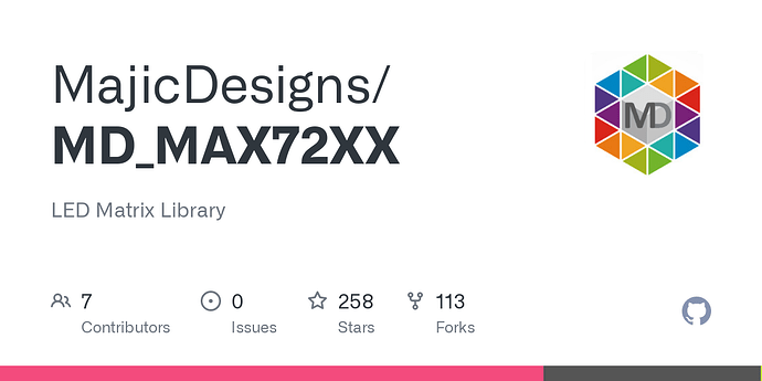

Correct link for Parola
This MAX7219 library?
Parola doesn't work for me. It gives a bunch of errors in the console about 'typedef' being ignored in this declaration. I was hoping someone would help me with the "dot" method I was using. I have this DMD animation that I made for my mini pinball backbox. It basically does a little Extra Ball animation.
