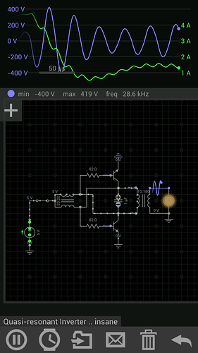

As some may know I use every circuit (for Android, ios, chrome) and I came across this circuit posted by a user... it's freakishly impressive!
5v to 100+ volts to power a lamp.
Not exactly magic. Its using a oscillator and a transformer.
Depending on the lamp, it will take significant current at 5V
The capacitor is incorrectly shown as polar.
Yes, definitely need to use something like a polyester film capacitor. A bipolar electrolytic would probably not survive long there.
There are no non polarized to select from in thus emu.
