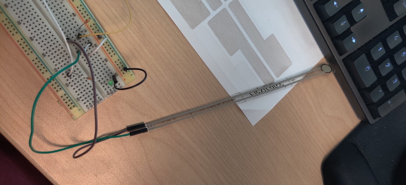

I mean I don't really know how to describe it very well and can't draw a circuit because I have literally zero experience with electrical engineering. But maybe these pictures can explain my setup? On the FSR there is 3 pins and im not sure what the middle pin is for. That could be part of my issue I guess.
Essentially what I have going on here is when I apply pressure to the FSR it is supposed to detect that pressure and output that to console as well as adjust the brightness of an LED(this is just for testing). However when I purchased it- it said the FSR would detect anything from 0 to 25lbs of pressure and I have to push VERY hard to get it to even register.

Thanks, but we still need to know the details on how you wired it up. A photo of a breadboard tells us nothing.
A link to the wiring diagram you used, or a hand drawn diagram of your own wiring would be helpful. We need to know the component values.

The code you posted is completely useless for making measurements. All it does it light up an LED.
What you want to do is measure the resistance of the sensor, which can be converted directly into the total force using a graph or a lookup table, following this guide: Force Sensitive Resistor Hookup Guide - SparkFun Learn.
For R1 in the voltage divider (3.3K) you will probably want a much larger value, comparable to the FSR resistance value when lightly loaded.

Here's what I'd do:
  • learn how resistor dividers (voltage divider) work
  • learn how the Arduino ADC works
  • use a digital multimeter (if you don't have one, buy one) to determine the resistances of the sensor (by itself, unattached to anything) without any load on it and with the "design" load on it
  • using a range of values of R1, starting with the excellent recommendation in post #9, calculate (yes, using a calculator) the expected voltages on the Arduino pin (at the center of the resistor divider) and the associated range of ADC readings
  • by trial (or math, if you are crafty), pick an R1 that maximizes the range of ADC readings over the range of "no load" to "design load" resistances (this R1 will likely be near the mid-range of the sensor resistance values you measured)
  • with the selected R1, hook up the resistor divider and apply 5v to it; then use your DMM to measure the range of output voltages over the "no load" to "design load" range; if your measurements don't match your calculated voltages fairly well, then go back and figure out what's wrong
  • hook up the resistor divider to your Arduino, and see if the range of ADC readings matches your calculations fairly well; if they don't, go back and figure out what's wrong
    If that approach doesn't give you the sensitivity you need, then you should use the "recommended" op amp circuit in the sensor datasheet (actually, I'd start with the non-inverting one in the Tekscan guide...) Those will be harder for a novice to implement than a simple resistor divider.
