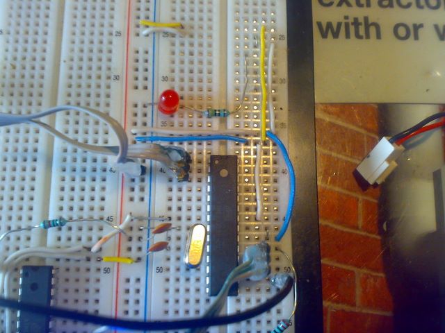

I tried to use arduino as isp. i connected everything correctly and upload the sketch. i pressed the burn burnloader button. after 30 seconds i get error and my microcontroller break. now it's not working. i tried it again and i break another microcontroller.can anybody help me? did it happend to you? BTW while burning led was blinking very fast with low light.

How about some good pictures of your setup. Make sure that we can traces your wires.
It would be very useful to know how you connected everything up - how were the various devices powered, for example. Can you post a picture of your setup?

I really think there's most likely to be an error with your setup. Any chance of a picture?
I assume the chip with the bootloader is running OK, has a crystal & caps attached, and is loading the Arduino ISP sketch OK. Have you also used a couple of decoupling caps on that one? Unstable power might cause you problems.

Have you really connected pins 16, 17 & 18 of the two '328s to each other? Have you connected pin 15 of the bootloaded one to pin 1 of the target one? Do both have pull-ups on their reset pins? Does the target chip actually have power? I've managed to do all of those things wrong at least once!

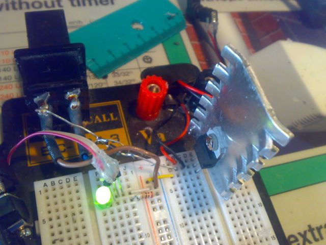

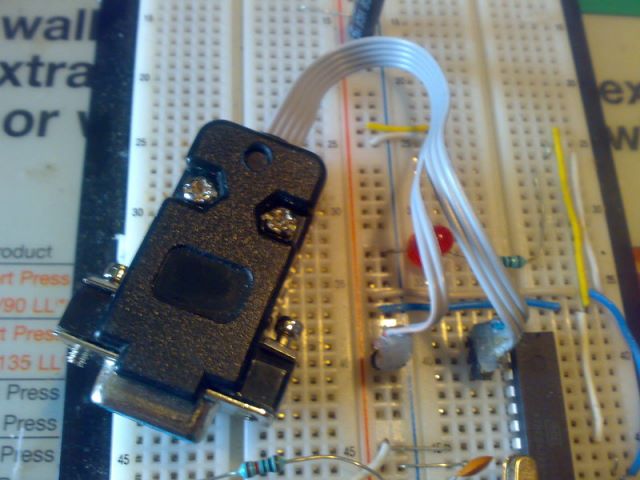

ok so here are some images. its powered with adapter 9v and stabilized with stabilizator. in cover of rs232 is max232 and some resistros and caps, its working because i can upload sketches with it. there are some extra wires that are not connected

here they are:
Have you tried with power to pin 20 of your target?
Also, what does the RS232 converter do with regard to auto-reset? Once you have uploaded the ISP sketch, I might try unplugging the 232 converter from reset and pulling pin 1 up with the normal 10K just in case it is resetting half way through.
pin 20 is connected but it's not seen on picture. i tried to connected only rx and tx but no results. the same error. any other idea?
