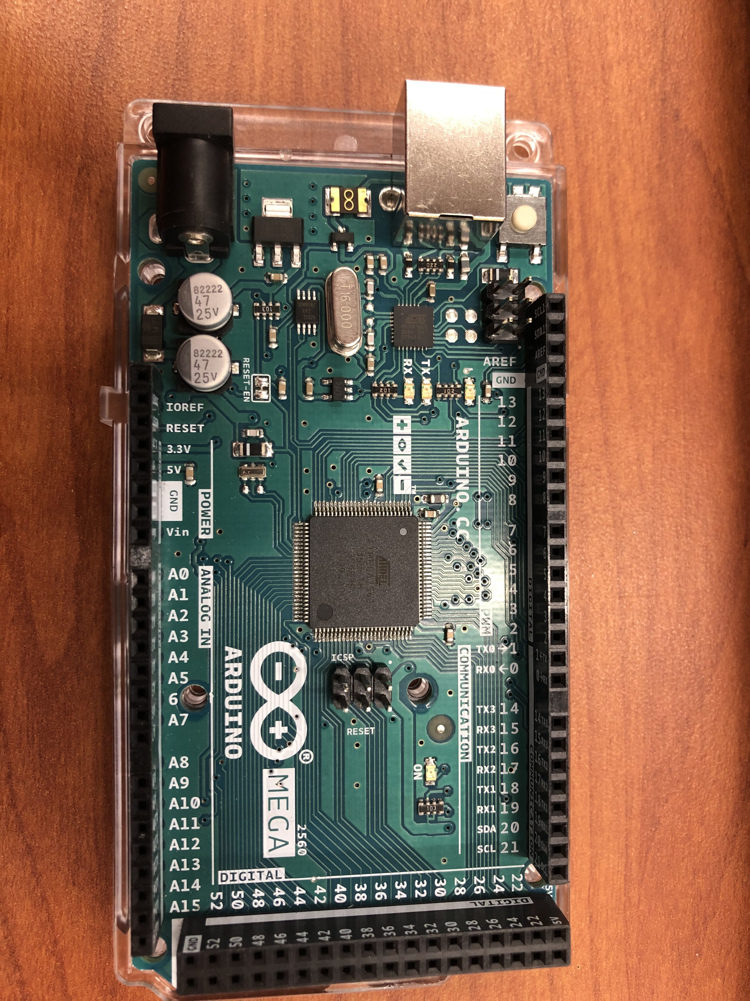

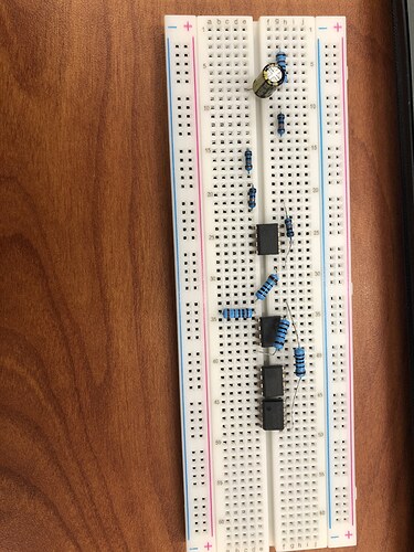

Here's what I have so far-
This is my arudino board-

Don't bend the pins open. Bend them a little together. To bend the pins together, I put them down on a table, so I don't need plyers. You have put the pins one row too far in the breadboard.
Then start with powering the OpAmps with the jumper wires.
The new circuit has seven OpAmps ? Then you probably need both breadboards.
I know it likely tough to get suggestions from every side but...
I think you have too much unused space between your parts.
I would try to keep the physical parts laid out similar to the schematic. Also know you can put resistors in standing up, they don't all have to be laying down.
I would start with U1 and its associated components then move through the circuit. You really would like to get it all on one board. Both for noise rejection and durability while testing.

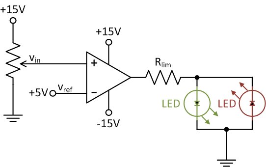

I suggest to start with a simple circuit 1 op amp with battery + -, and ground.
R0e64aafa80dfb408285b70165519fa2a
use 9V batteries instead of 15V

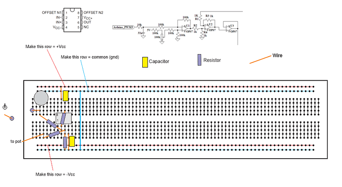

Here is a start, I've laid out the first opamp.
Regarding the capacitors, notice none of the authors is associated with the electrical engineering department. On anything electrical, especially with large value resistors, noise will be picked up on the wire and component leads. A capacitor from the power to ground will help alleviate the noise and you circuit will perform better and with less "bouncing around".
Hey John! I've made the connections for the first opamp as you suggested. I'm not too sure if I connected the right resistors, do you mind color coding the 1k,10k,100k resistors and the 0.01uF ,33uF capacitors? Also, what is that big circle and the 'to pot' connection? I also see a resistor outside the breadboard which I don't understand.

Layout.
I think it is best if you trace the components. You will need this ability to finish. But you will need one additional bit of information:
So you use the attached diagram to id the pins from the schematic.
For example Amplifier Pin 6 and Amplifier 2 have a 100K connected between them. Look a the diagram and see what resistor is connected to those two pins and it will be a 100K.
It is easier than you think. I realize your are in uncharted waters and it would help if someone was looking over your shoulder. However I am confident anyone who would be working with such a cell has the where with all to grasp the schematic --> Pin # --> pin location --> physical layout.
