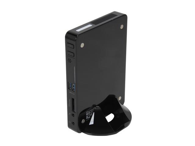

I have a clean install of Windows 7 Home Premium 32 bit on a Nettop nt-i1500. There is no other software installed on this machine.
I downloaded the zip of Arduino version 1.5.8. When I click the arduino.exe file in windows I get a splash screen and then it vanishes. The IDE does not load. Located in the arduino-1.5.8 directory I found files called hs_err_pidXXXX.log (where xxxx is a 4 digit number) that is created every time I try to start the IDE. It appears to be an error log. I have attached on of the files below.

This is a fresh install of Windows 7.
This particular box is a barebones computer from Newegg.
A friend gave it to me. It originally had XP on it. I used the Windows 7 and did an upgrade install. I had all the problems I've detailed here. I had the same thoughts as you, that there could be something left over from XP or the old installation. I formatted the drive clean and then did a clean Windows 7 install. I then did all the Microsoft updates and then used the zip version of the arduino software (no installation done).
So there you have the history, there should be no lingering policies and while it is not a new computer, it is not a refurb and I basically built it.
