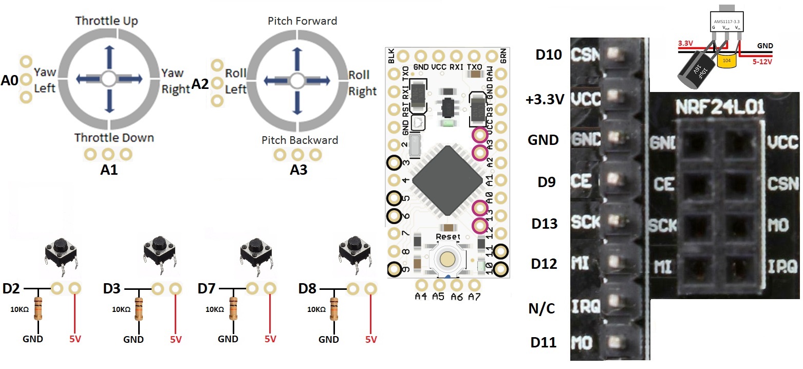

I'm trying to hoke up arduino mini pro with the NRF24 module to use as RC. but NO success so far :frowning:
the code i run is called pingpair.ack (lib example can be found with in the Arduino IDE).
i supply 3.3v from a stable power supply and also added a capacitor 100micro farad between + and -.
i checked my wiring and also the module.
when i hookup Arduino UNO with NRF24 and print connection details all look fine
and even changed the data rate :slight_smile: to check internal connection
i replace uno with pro mini and it looks like it is not connected (wiring is OK).
(for UNO CE and CSN 7,8 and at the mini pro 9,10)

example from mini pro for printed connection details
RX_ADDR_P0-1 = 0x0000000000 0x0000000000
RX_ADDR_P2-5 = 0x00 0x00 0x00 0x00
TX_ADDR = 0x0000000000
RX_PW_P0-6 = 0x00 0x00 0x00 0x00 0x00 0x00
EN_AA = 0x00
EN_RXADDR = 0x00
RF_CH = 0x00
RF_SETUP = 0x00
CONFIG = 0x00
DYNPD/FEATURE = 0x00 0x00
Data Rate = 1MBPS
Model = nRF24L01
CRC Length = Disabled
PA Power = PA_MIN
i read alot of posts but didn't found the answer to the problem. why mini pro does not connect to NRF24?

hi. i have an adapted drone control with both, with many of connections (2 sticks and some buttons) and works perfectly.
Aprox schematick (i adapted to post)
Xakko
Please post a schematic showing how the rf24 modules connect to the Pro Mini boards.

The pro mini is not connected properly, MISO seems to be clamped down.
what do you mean?
which label is the MISO?
How to control it?
You have a wiring problem.
MISO is the name of one line of the SPI bus, going from NRF-MI to ProMini-D12.
Data on that line is supplied by the device, and read by the MCU.
Connect D12 with MI and both with nothing else.
Your output could point to an unwanted connection to GND.
