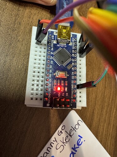

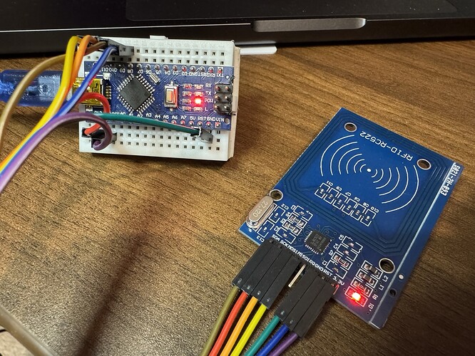

I have this RFID working on an ESP32 and an Arduino Uno R4. But I cannot get this to work on the Nano.
Photo below. I've checked the wires 10 times and I've even uploaded a photo to ChatGPT and it says its right too.
I cannot figure out what is wrong
I have
SDA (SS) → D10
SCK → D13
MOSI → D11
MISO → D12
RST → D9
3.3V → 3.3V
Sketch below, (works on ESP32 and Uno R4)

Any ideas what could be wrong with the nano setup? These are Elegoo boards. I've tried 2 diff ones so far.
edit: this is the board I bought

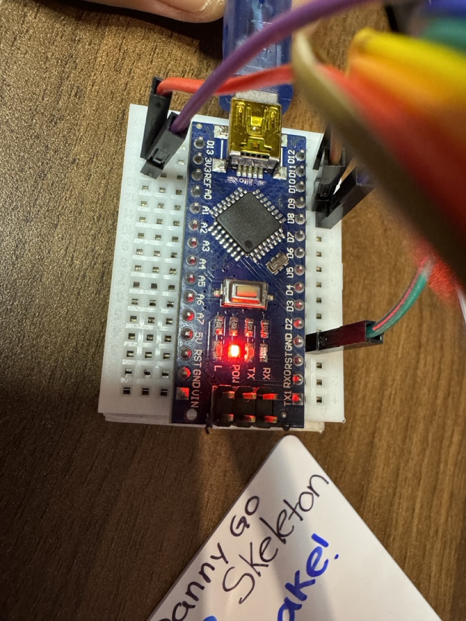

Are the Nano headers soldered to the Nano? It's not quite clear from the image.
If not, solder them.
My next step would be to check if the reader still works with e.g. the ESP32; incorrect wiring might have resulted in damage to the reader.
That is not the way to do it; you need either voltage dividers or level converters. MISO does not need one but MOSI does.
Yeah, it does look like it in one of the photos. A little lean on the solder, but looks OK.

Yea the headers are soldered on there. I can try pulling all the pins up and checking their voltage to make sure they are working.

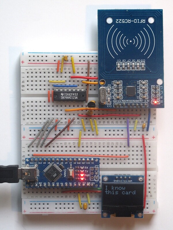

Here is a clone Nano running a modified version of your sketch. It has been changed to allow more than one card read, and to output to an OLED display.

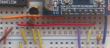

It uses an external 3.3V LDO regulator to take the 5V line down to 3.3V. Besides the regulator, 2 capacitors are required.
In addition, a 74AHC125 is used as a level shifter to translate the Nano's 5V level outputs to 3.3V levels to stay within what the the MFRC522 can handle.
And as you can see with your own eyes, when used with a proper 3.3V supply and level shifters, a Nano is perfectly capable of communicating with the MFRC522. But feel free to keep doing it your way. I'm done here.

It looks like you have RST going to 2Y, then out 2A to pin 9. Then SS(SDA) going to 1Y then out 1A to pin 10. You've grounded 2OE and 1OE and 4OE and 3OE. MOSI is going in 3Y (not pictured) and out 3A to 11. And MOSI is going straight to 12.
  1. I've read the datasheet as best as I could, I don't see where it says 5v in provides 3.3v out. What in the datasheet indicates that would happen?

On the bread board setup it's not visible what the 3.3V input on the RFID module in your setup connects to. I suspect it's connected underneath the module to the 3.3V rail that you fed with the 3.3V (1117?) TO92 regulator, yes?
Have you tried powering the RFID from the Nano's 3.3V supply to demonstrate whether that will indeed create problems as often said?
