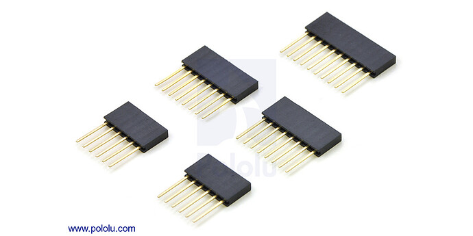

I can't seem to find this information in datasheets or elsewhere. What is the pin size of the nano?

The header pins shipped with Nanos, which are the same as the pins that would fit in Uno headers are 0.64cm
The machined pin contact headers in your DigiKey links are not compatible.

pin size for all UNO/NANO/MINI are .025 square.,
you linked to machined round pin sockets, will not work unless you get the right size. the acceptable male pin that it will accept is on the data sheet. make sure it will be large enough for the square pins of the arduino / nano
you can find machined sockets that are for round pins that you can force the pins into, but it is not easy to insert or remove.

My main issue is that these plastic, squarish headers are so tall and my nano+header won't fit in the enclosure I am using. I need to find a low profile solution. I noticed that the regular IC sockets I use seem to accept the nano's pins. I just can't seem to fins a 1x15 row of it.
you can find shorter headers. look at the xbee headers. not sure of they are 0.05 spacing, if so, remove every other pin.
you can get the round ones you showed in wire wrap, (long tail) with various lengths of tails.
you can get IC sockets. that is what I use. get them in the right count, cut them, use the NANO as the alignment tool when soldering.
I think I can use a regular 2x32 IC socket (4832-6000-CP 3M | Connectors, Interconnects | DigiKey) and just remove the last two rows. I test fitted my (broken) nano into a 2x8 socket and it seems to fit quite snugly.

you can remove the pins pretty easily to make sure you do not solder or plug it in wrong.
Machine pins, sometimes called Swiss machine pins, are lower profile than the usual Arduino headers. If I am running out of space like that then I usually find I need to solder directly to remove the header entirely.
