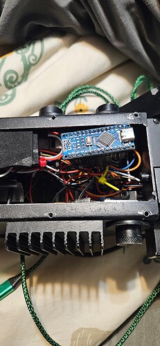

As the title states, applying 12v to the Vin pin on my Arduino nano seems to stop the Tx pin from sending data. Actually, it seems to stop it from doing much of anything. My code is set to send 10, 1 digit data numbers to an Arduino Mega 2560 every second. When I plug the Nano into my computer, the serial works fine, albeit none of the LEDs connected to the Nano work regardless of whether the serial is working or not. Could it be an issue of too much supply voltage, or could there be a short somewhere in the mix causing the serial to freeze?

Schematics are on the way. Photos will be difficult since it's all in an enclosed metal box. Circuit worked fine until installing everything and now it's just acting up.

  • Can you take a picture of the Arduino in the case.

  • Highly suggest you neaten the wiring up; the Nano should be secured.

Wiring is... neat as it can be. Much of that open space is needed to stay that way. I was not aware that those were only analog input, however that should be an easy switch. The code depends on the first switch (A0) to activate for anything else to function, so I haven't run into the problem of A6 not working yet. The nano is also usually secured with shielding, I've since removed that shielding to give visibility

Trust me. This is as neat as it can get considering it would be torn out of the breadboard with the spring mechanism if it's any further out. Here's the code, though.
