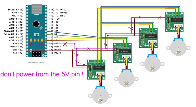

I built a steam-punk-like Zeppelin Lamp with 4 rotors. Each has a 28BYJ-48 Stepper Motor and all wires run together inside.
My goal is to run all 4 motors equally (same direction, same speed, same timing).
Each motor is connected to a driver board. Each board has +-5V and 4 controller pins.
My questions are:
  1. Since the Nano does only have 12 digital pins, does it work when I attach 1 Pin on the Nano with 4 driver boards? (meaning Pin D2 Nano -> 1to4 with one on each driver board, D3, D4, D5 similar).
  2. Is it ok to attach all 4 driver boards 5V+- on the 5V/Gnd on the Nano?

You shouldn't connect 4 motors in parallel to one driver board, but its OK to connect multiple driver boards to shared pins on the controller. For eample, the Protoneer CNC shield can connect two separate drivers (A to ??) to any of the other axes step/dir signals and run them in parallel, or run them on independent pins. The Enable signal is shared by all the drivers.
If you want independent motion, you need separate DIR and STEP pins for each independent motor.

Hi, @didda
I think @didda means each cable from each stepper is run together inside the Zeppelin, then connected to 4 separate drivers.
If they are the ULN2008 then you can connect each of the four control input pins together to a Nano pin.
So pin 1 of each driver is connected together and then to a pin of the NANO.
And so on with the other 3 pins.
However you will need a separate 5V supply to power the steppers.
I hope that is what you mean.
A circuit diagram is much quicker and more accurate than words to explain a circuit.

Hi everyone,
sorry that I didn't do the circuit diagram right away. Here it is.
1 out of 4 works perfectly. I have not tried all 4, since they are already built into the zeppelin and I dont wanna break components.
At the moment, the arduino is powered via USB from my PC for testing. I have a 5V WS2811 LED Stripe inside the zeppelin with a poweradapter - I intend to use this powersource and attach the arduino to it.

How are you powering all this? You don't have any power connections on your diagram. Since you are running all 4 steppers at the same time, you are pulling 4x the amount of current.
Hi blh64,
as I wrote, my test environment is powered via USB connection of the nano.
For my final setup inside the zeppelin, I have a 5V power adapter which currently runs a ws2811 stripe. I plan to use this source the for arduino/stepper as well.

The important detail is connect the 5V power
directly
to the driver-boards and the Neopixel LED-strip.
You should
not
use the 5V of the arduino nano.
The 5V pin of the arduino nano can not provide enough power
The principle shown here for how to power a RC-servo applies the same way for your stepper-motor-drivers and the Neopixel-strip
only in case your external power-supply has stabilised 5V
you could connect to +5V instead of Vin
best regards Stefan
Hi Stefan,
thanks for your advice on powering! Is the controlling (4 cables to D2/D3/D4/D5) working? Of course I do not want to rotate differently.
Regards,
Christoph

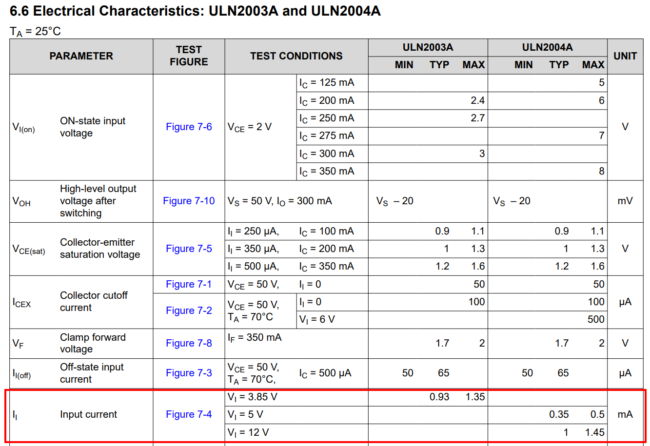

Yes. The input-pins of the ULN2003 driver-chips are drawing a small current in the milliampere-range
You should learn to look up datasheets
