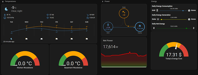

I have scoured the internet for a solution and decided to create an account to ask you fine people! I have an Arduino Uno r3, I have wired 2x maxx6675 thermocouples to it. I coded the Arduino and got it to spit out two readings when I open the serial monitor!
So the two problems I think I have are:
  1. How to get the Raspberry Pi to read that Arduino data over USB connection?
  2. How do I get Home Assistant to get that data and show it as a sensor?

Homeassistent has an integration for serial data. It also includes an example for Arduino.
I tried that, but it didn't work. I can't seem to figure out how to use that integration, I fiddled with it for a few hours and can't seem to get it!. Perhaps my Arduino code is not written well. This is the code I had uploaded to the Arduino Uno r3! I just copied it from the old ESP 8266 board that died. I am quite a newb, and will hopefully clean up that code anyway to make sense better as to which stove it is monitoring!

I would probably try the format from the example:
$,24.1,50,12.9,1029.83,0.0,0.00,*
On the Arduino side, it would be similar to this:
Serial.print("$,");
Serial.print(ktc1.readCelsius());
Serial.print(",");
Serial.print(ktc2.readCelsius());
Serial.print(",*");
Serial.println();
And for the Homeassistant side this would go to the configuration.yaml:
(Needs adjustment for the port name)
sensor:
  - platform: serial
    serial_port: /dev/ttyUSB0
    baudrate: 9600
template:
  sensor:
    - name: ktc1
      unit_of_measurement: "°C"
      state: "{{ states('sensor.serial_sensor').split(',')[1] | float(default=0) }}"
    - name: ktc2
      state: "{{ states('sensor.serial_sensor').split(',')[2] | float(default=0) }}"

omg... I didn't even know how to ask.... You literally just fixed everything for me. You have no idea how long it took me trying! Also, I learned a lot from all of these reply's!! The only difference is I took the "/dev/ttyUSB0" and made it "/dev/ttyACM0" like you said and boom. I can't thank you enough!! Your formatting and home assistant code was too good to be true haha!
