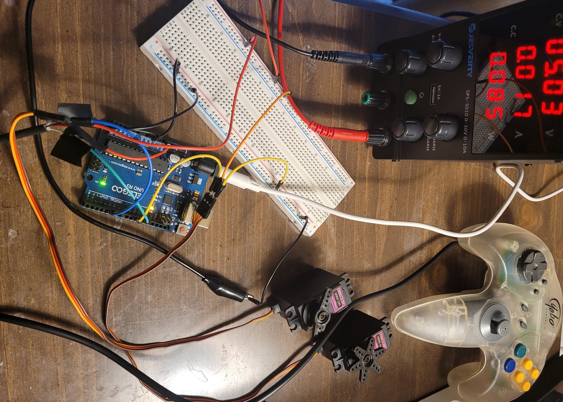

I am working on a robot arm controlled by 6 servo and a stepper. I using a N64 controller to control the arm and the arduino uno is the main board. I am worried the PWM signal is causing twitching of the servos. I have hooked up to pin 5 and 6 and get slight twitch but the go to 9 and 10 and get much worse twitch. I am testing these with a bench power supply so i know its not a powers supply issue could it be the PWM and is there a way to fix this?

It is probably a power supply issue. Show your wiring diagram and your power supply specifications.
Explain how you can be sure of that. Did you scope it? The schematic will get you a good answer much faster then playing guess where the bug is.
Yes, we know. You have another topic with the same subject. Refrain from cross-posting.
I did scope it at my work going from pin 5 output to ground and noticed some slight irregularities. When I used pin 9 I noticed the twitch is a lot worse so I am going to scope that pin today.
I apologize, I did not think this was a cross post because that is a programming question asking about best practice and this is a hardware issue. Also, I have had no responses to that post. I would have asked anyone for help if someone had taken an interest.
I am using the Jesverty, SPS-3010 DC power supply, 0-30V, 0-10A. The reason I do not think it is the motor or power supply is because I do not have this issue when I hook up the same motors to an ESP32, but this code is not compatible with the ESP32 so I have to use a different code. I will get a wiring diagram done shortly.
testing 1 or 2 at a time gives the same result
The drawing does not match the code. Why did you define pin names, then never use the names and only used hard-coded numbers? These flaws indicate you have caused mistakes in the code and the connections.
Your project will only work if you clean up... so start by removing every device and wire.

I measured the voltage of the power supply and it measures 5.0 V on the multimeter. I have tried powering the Arduino Uno from the power supply with the servo motor and powering them separately as shown in the first schematic. The first schematic shows my trails with only one servo and the twitch is still present.
I have all the extra code in there because it is intended to be for all 6 servo and 1 stepper when complete. I have gotten rid of all the "extra" code and Libraries so it is only the first two servos.
The twitch is under no load and it twitches when not moving and when moving. I worry it is the board that is causing the issue. The only other thing I can think of checking if the Servo.h library code is causing this. I have hooked it up to oscilloscope and there are some irregularities.
Is there another library that can create the PWM on Arduino Uno?
I have purchased PCA9685 servo driver see if this helps it does run a different library.

I put together this "no library" servo program that uses pulse width to position the servos. You could try it with your hardware. Understand that the simulation pulse width will be different from your servos, so you will probably need to adjust the pulse width in the code to suit your servos for the full 180 degrees.
Just putting these links here for reference:
I have used your code to create the PWM signal and the twitch has gone away. I altered it to increase and decrease pulse width based on serial input. I am looking into this further and maybe an old version of the servo library will not give me this issue, but it did start twitching again when I used the code with the potentiometer. This could be because I powered both off board. I will try again with my power supply and see if twitch goes away.
Here is my version of code with serial input, also, getting rid of the delay(5) did help reduce the twitch.
