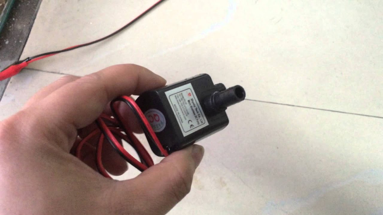

If, I select this DC motor
https://www.ebay.co.uk/itm/Mini-Water-Gear-Priming-DC-3-12V-RS-360SH-Spray-Pumping-Motor-Aquarium-Fish-Tank/122080701311?hash=item1c6c93ab7f:g:3B8AAOSwMtxXrMWF:rk:1:pf:0
what other equipment will I need ?
"I would like to do a home decorative project with 2 DC motors that will be underwater"
Why would you choose that motor when it very clearly says "Note: This pump is not a submersible pump, it can not be put in water."?
Steve
yes, I had initially bought these 2 in the past, thinking that they will provide water with silicone tubes, but I changed my mind...
what about starting with a DC30A-1230
