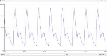

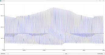

With a delay of 100ms you are only taking 10 samples per second, and are less likely to capture the peak of the waveform.
See the following plots from the serial monitor:
(I don't have a pulse sensor, the traces are from an arbitrary waveform generator to simulate the pulse sensor).
With a delay of 10ms the waveform is captured nicely - all peaks the same height.
With a delay of 100ms the apparent amplitude varies considerably.
