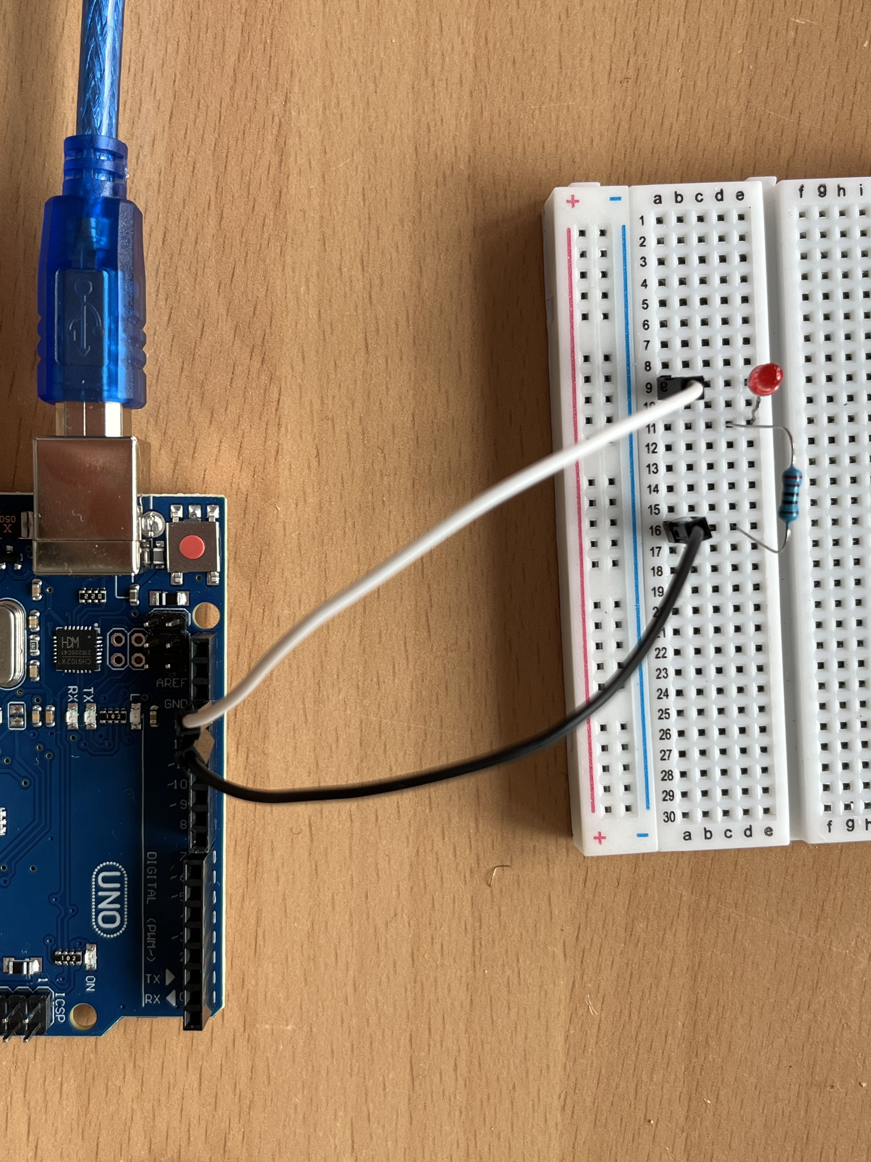

I am new here and I have a question. When turn on Arduino LEDs TX and RX are constantly on, but dim, almost off. Everything works fine, I can upload programs etc. But I am worried that I created short circuit while trying Pulse Sensor. Thank you for your help.
Adding a photo of dim LEDs.

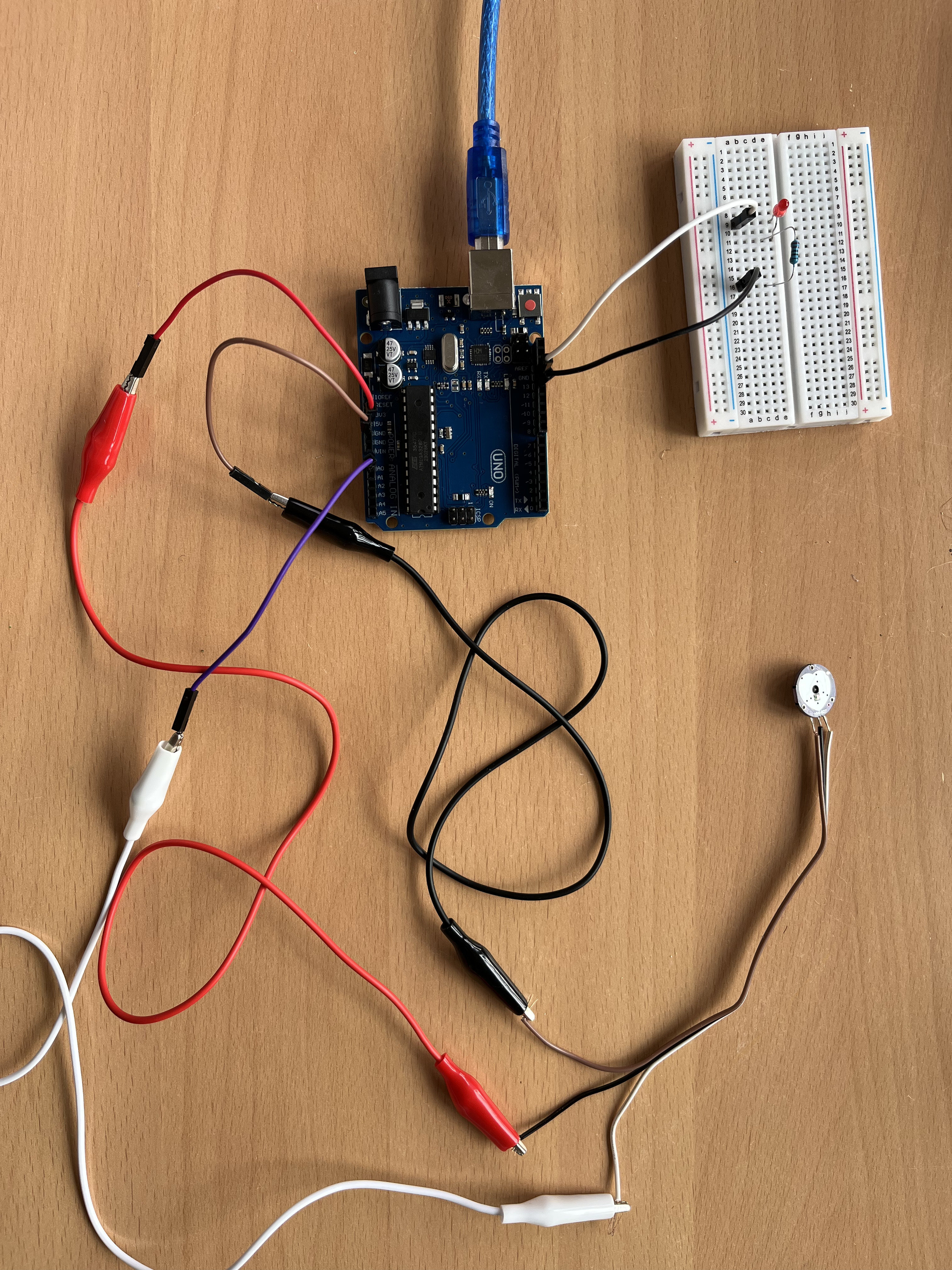

Do you maybe know what am I doing wrong with the Pulse sensor? It’s working, but not correctly. Does not read pulse and turns off LED when finger is placed on..
did you connect it to 3.3v or 5v?
try increasing the main loop delay to like 100 ms delay(100);
With 5V. Ok, haven’t changed delay yet, will try. Thanks.
So, I have changed loop delay to 100 ms. Nothing really changed. Sensor "works" but not recognises pulse. When I wave above it, LED13 blinks, but when finger is put on it, LED13 stays OFF. I've changed the Treshold from 10-1000 but it stays the same. Not sure what else to do. I even tried A1 pin.
Can you please post some images of your project, UNO and pulse sensor connected?
Thanks... Tom...
