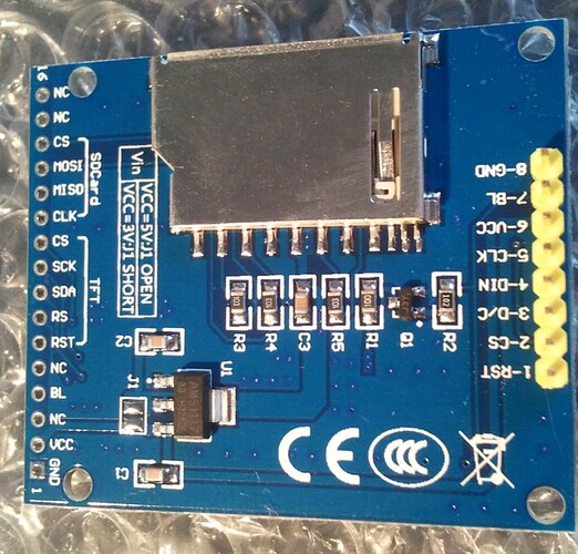

I recently bought a 1.8 SPI 128x160 pixel TFT from China. The TFT had a plastic wrap with a Green Tab.
http://www.ebay.de/itm/1-8-Serial-128X160-SPI-TFT-LCD-Module-Display-PCB-Adapter-with-SD-Socket-/201013566537?pt=Bauteile&hash=item2ecd579c49
The picture IMG_20140216_145845.jpg shows the back of the tft display and the pins to connect the display to the arduino uno board. Compared to similar tft displays, this one has pins on two sides. I suppose the side with the larger amount of pins has to be used if the sdcard reader should be used. I assumed that I can use the 8 pins on the other side as I only want to use the tft display. After reading a couple of tutorials I first wired the pins 6 to 8 and afterwards the pins 1 to 5 of the tft display to the arduino uno board using following configuration:
TFT -> Arduino Uno
1-RST -> Digital 8
2-CS -> Digital 10
3-D/C -> Digital 9
4-DIN -> Digital 11
5-CLK -> Digital 13
6-VCC -> 5V
7-BL -> 5V
8-GND -> GND
With this configuration the backlight works properly. However it is not possible to display something else with the Adafruit_GFX and Adafruit_ST7735 library. I initialized the ST7735 Chip using the Greentab flag.
tft.initR(INITR_GREENTAB);
Also within the code I am using following configuration
#define cs   10
#define dc   9
#define rst  8
and
Adafruit_ST7735 tft = Adafruit_ST7735(cs, dc, rst);
Does anybody know what I could do to turn this display into a working display. I am wondering whether I did something wrong or the display is broken due to bad quality.
Thanks a lot for your answers in advance!

It seams from some research you need to put 1k resistors on all I/O pins.
See link: Cheap 1.8″ SPI 128×160 TFT Module – Arduino wiring! - Domipheus Labs
Hope this helps :smiley:
The driver for this board is a Samsung S6D02A1 and you need to download it from Git hub GitHub - zigwart/Adafruit_QDTech: 1.8" TFT LCD library for Arduino and QD Tech / Samsung S6D02A1
Using this Arduino software will make it work. Also took me two days to figure out. According to the data page the resistors shown in the previous post is needed.

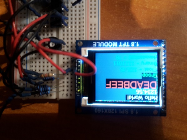

Well, FIN-ALL-Y!!! :slight_smile:
I really really have to thank you, it's now working perfectly.
I can now finally continue with my actual project that I bought this TFT for... :stuck_out_tongue:
@carguy
Can you confirm that swapping to a ST7735 library has helped.
However the display image in post #13 is not exactly as it should be, for example there are random pixels on two edges of the screen.
I am guessing based on the screen image that you are using my TFT_ST7735 library. In that case you need to edit the User_Setup.h file inside the library folder to change some display parameters and get the displayed image corrected. Inside that file you will find some #defines, edit the file to change the option, for example the default is:

Yes, I think I had a red tab on the screen protector, I've changed it now and it looks ok.
