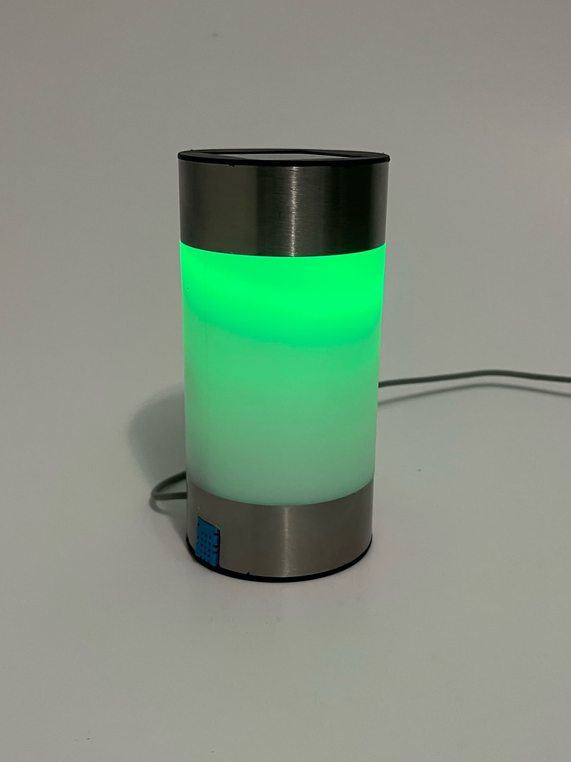

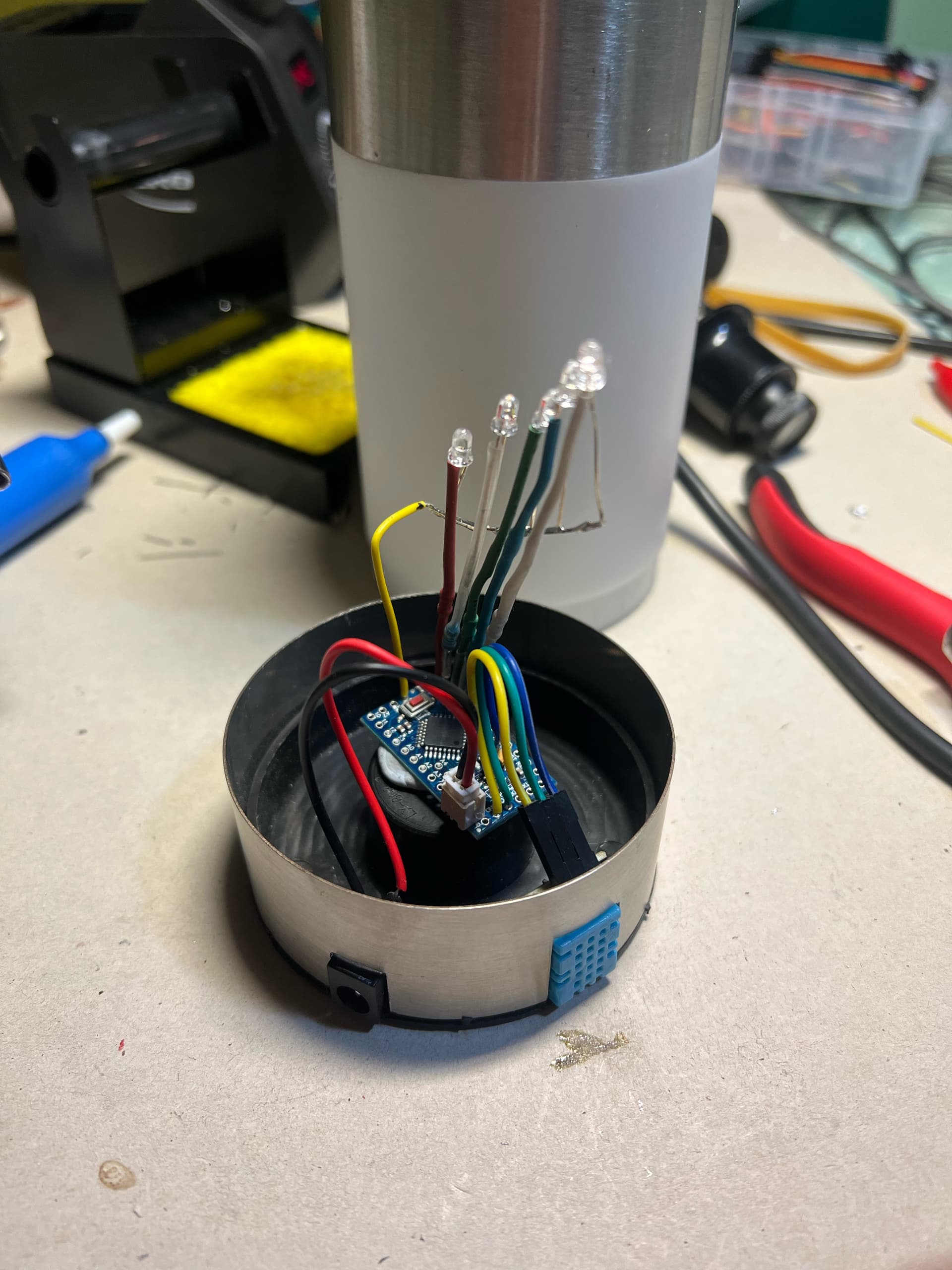

Ok folks, I've finished the project. It came up pretty alright, well from the outside anyway. So here are some pics. I went with the Pro Mini and a $5 garden solar light, with only slight modifications, for the encloser.
Well Done. Nice packaging
