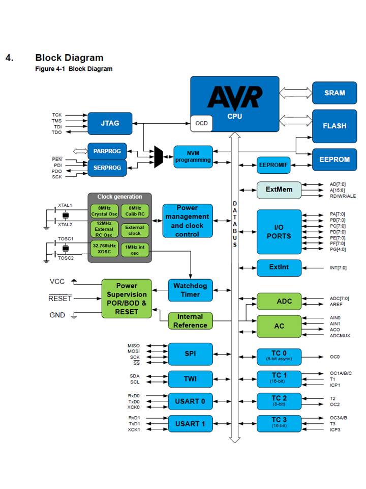

I was reading that you can program over the SPI interface, but the MOSI and MISO should be connected into RDX0(PD1) and TDX0(PD0) of the AtMega128, and also pull /PEN low at the time of programming
New look to Atmel Block diagrams, this one from Sept 2015 datasheet.
128A, 128L are similar to 1284P, a few more IO pins (53 vs 32). 1284 still king of SRAM with 16K, vs 4K in 128 & 8K in 2560.
If one was to program over the SPI interface, I'd expect you'd connect the programmer to Reset, SCK, MISO, and MOSI like you'd do with other AVR chips.
Which are not the pins mentioned in Reply #9.
See page 14.

mcnobby:
Yeah, that got me. You do have to hook it up that way, or you can use the JTAG pins to allow debugging. I am trying to get it to work with u8glib, having some trouble. It does come up and can be programmed over both JTAG and ICE. Those chips look good. The problem I am having is with the u8glib.
CrossRoads:
McNobby is right. They do it differently for this IC. I verified it. Does not work with MISO and MOSI. This breakout board routes RTX and TDX to the ICSP header, it does not work the other way (they use a 10 pin header version but it is the ICE "SPI" interface):
See schematic, page 8.
JoeN:
McNobby is right. They do it differently for this IC. I verified it. Does not work with MISO and MOSI. This breakout board routes RTX and TDX to the ICSP header, it does not work the other way (they use a 10 pin header version but it is the ICE "SPI" interface):https://www.olimex.com/Products/AVR/Header/AVR-H128-C/resources/AVR-H128.pdf
