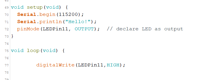

This is my code
Which arduino and boot loader?
Get rid of the serial stuff at the start - just set the pin as output and, turn your led on in the setup

That doesn't compile, you're missing a } after loop() :smiley:

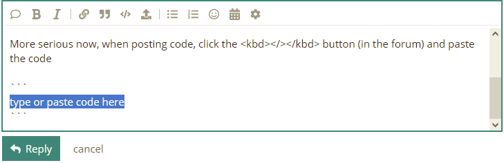

More serious now, when posting code, click the </> button (in the forum) and paste the code.
