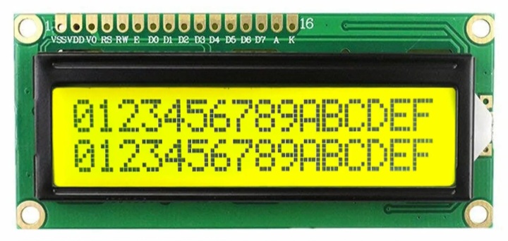

Good Morning everyone,
Im trying to replace a VFD with a 16x2 LCD display. I tried to find the manual for the VFD. Closest I could get is from the service manual of my sampler I own which breaks down the VFD display about. Luckily I have pictures of that and the LCD I bought too I want to (and hope somehow) I can solder in place of the VFD. Since I intend to desolder the VFD out and sell it probably since Im not crazy over it.

This is the LCD I bought; the LCD 1602 Yellow-Green 16x2 HD44780 Character Display Module for Arduino LCD1602 (as described on eBay)

I would say unless you have intimate knowledge of the main board circuity, which goes beyond just having a datasheet for the display, and full control of the software or f/w on that main board, then the answer is going to be not possible.
Based on the number of pins on the VFD, I'm assuming that the VFD segments are driven directly i.e. there is some h/w that scans across each character position lighting up the needed segments in each character position.
Also, VFDs use high voltage and I don't see the circuitry for that on the display, which would mean that the interface between the main board and the VFD is not TTL levels.
i.e. above the 5v used by the LCD.
The new LCD you have (BTW, they are also available in 16x1 versions), is an hd44780 display.
It uses TTL voltage levels, i.e. levels a 0v and 5v.
The hd44780 interface uses a command interface across a 8 or 4 bit bus.
i.e. the host processor on the main board sends instructions or characters to a processor on the LCD.
While it might be possible to replace that VFD with a hd44780 LCD, it would not be just a simple matter of soldering up wires.
You would have to figure out how wire in the new LCD to signals that the main board could control at TTL levels.
Then you would have to modify the f/w on the board to know how to talk to this different LCD.
--- bill

I had a feeling this one would be tricky. Ill keep looking into this so I dont assume I know what Im doing and that way I wont mess it up.
