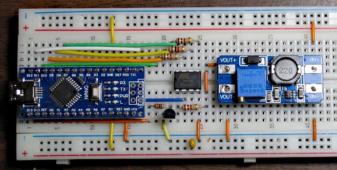

Rather than trying to free up a pin, how about adding one and using the reset pin for I/O?
A while back, I found myself in a situation where I needed all 6 I/O pins on an 85 and so I built myself a high voltage ATtiny85 programmer with a Nano, a handful of resistors, an NPN transistor and one of those ubiquitous boost converters. I started with the following:
The modified ArduinoISP sketch has an additional command for manually setting the 85s fuses. Then you just use it like the normal ArduinoISP programmer to upload your sketch. Here's what the breadboarded version ended up looking like:

Yes maybe the high voltage programmer will be the solution but as I saw 3pins attiny85 is possible I'm wondering to make it work like this with the simple usb programming.
