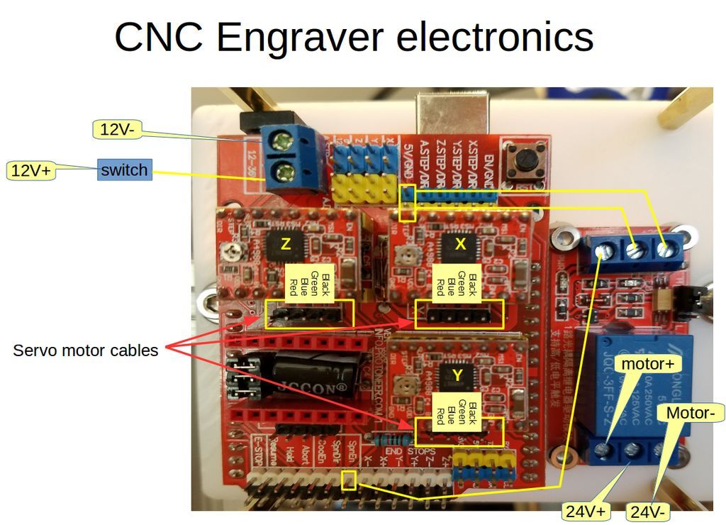

#13's "I would also refer you to a thread Danger and myself have in which there are also some decent tips." This link opens an image of my board.

"CH340C part" would I assume be the UNO that drives the whole thing.
That can be tested separately from the cnc shield anyway just by treating it as an Arduino UNO and sending sketches to it to check parts of the board.
The cables can be easily checked both visually and with a simple multimeter and usually dont need replacing
I would recommend mounting the UNO on a thin piece of plywood or some other thin but sturdy material the same size as the mounting for your original board to make sure the UNO remains insulated from frame of the machine. It will also make it easier for you to mount and test the machine when the time comes.
As it uses less space than the original you may also be able to add a couple of smaller add on boards at a later stage. I have a relay board on one of mine and a small voltage regulator board for ancillary items.
That is, if not exact, very similar to my board. (mine has "proteneer.com" on it)
If you use the link below this post, you can see a bit larger image.
And by no means is plugging the steppers in like I have the best way of doing things. It works for me though.
But those are all the connections you NEED to get running.
You do need a way to power your spindle. I have mine powered through the board that came with my machine. That part of my board is working fine for that.
Don't forget to put a piece of insulation tape across the top of the USB connector on the UNO before you start to play.
Somebody recently had an issue with shorting out and whilst not really mentioned in most places it is a little trick that may save you some headache.
By CH340 part, I mean the SOIC16 integrated circuit next to the USB port that converts from serial to USB. I'll try replacing that, since my existing board won't drive the spindle any better than it does anything else. I was wondering how the UNO board would handle the spindle, and I guess the answer is it doesn't.

Simply replacing the CH340 chip does not guarantee any sort of fix.
They have been proven to be a lot more durable than the standard arduino approach so chances are that if you destroyed that you also did some other major damage. Board rework at that level requires specialist equipment.
It was also the same reason we suggested the UNO and SHIELD approach as it makes swap outs a simple process and the UNO becomes more isolated from the shield in some regards.

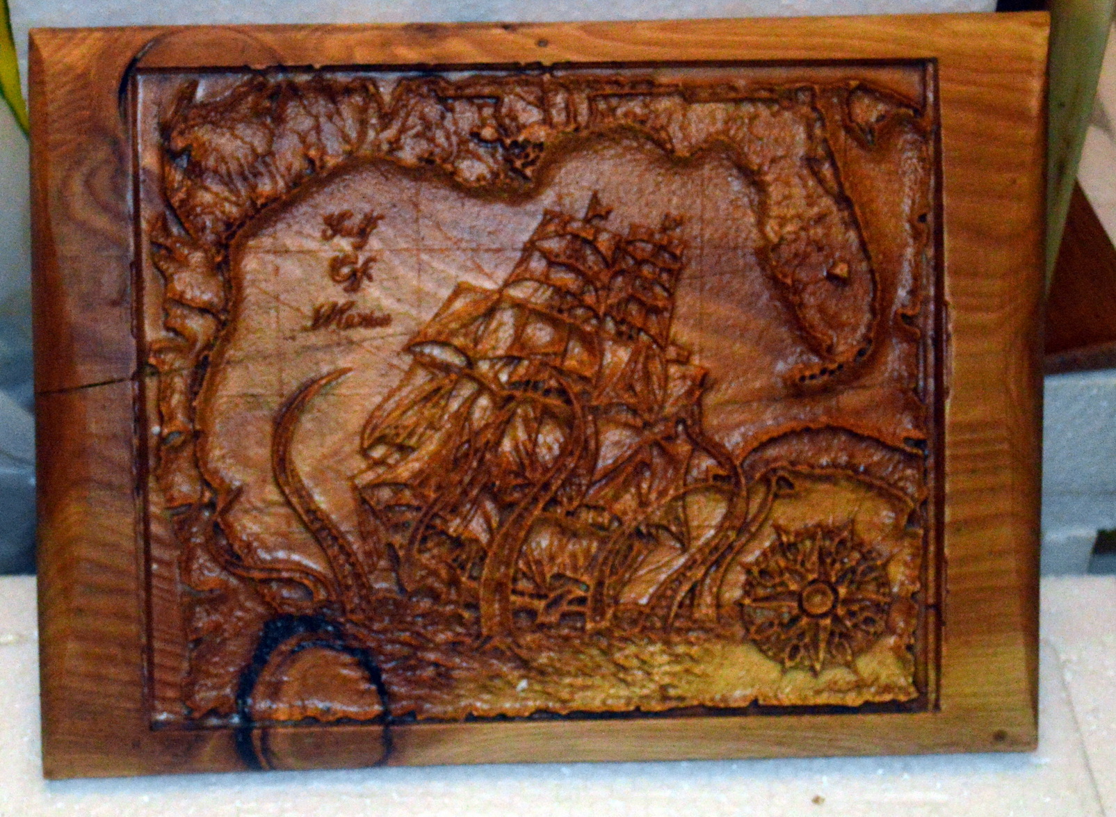

made with UGS.

Show off :smiley:
@Danger
Sometimes peeps get inspiration from others...
And yea I was quite proud of em seeing nobody taught me how to do it.
