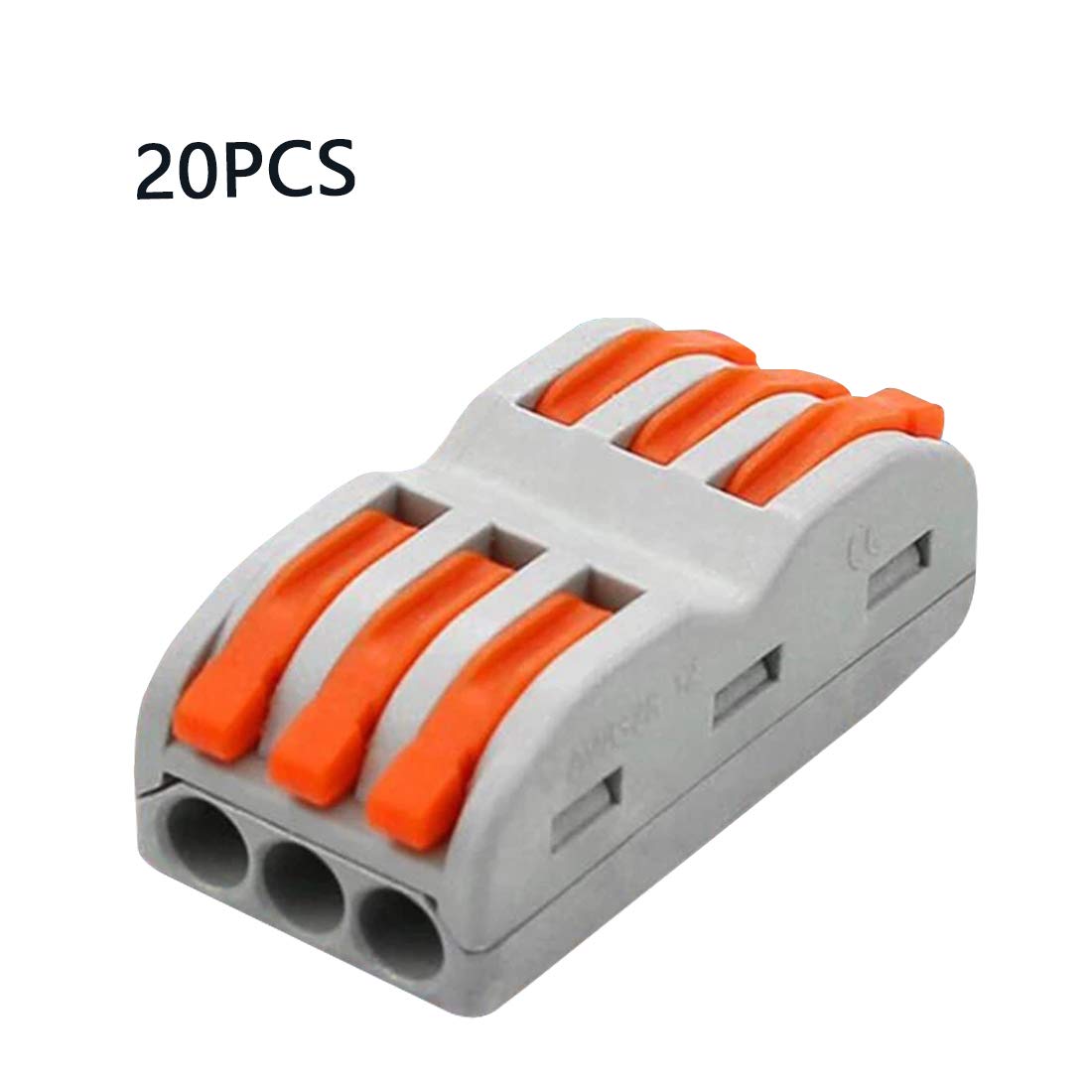

These are a bit kludgy, but I have a project with a separate cover and base where I don't want to solder the wires between them. They are rated for wires from #28 to #14 so it's quite versatile.
Looks good, I've been thinking of these. But maybe I'll use the thinnest wires, so it may be too heavy.
