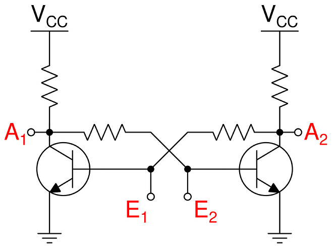

Good morning everyone, I'm making a simple circuit and I was thinking of using a self-holding relay as a rudimentary memory, I would like to ask you if instead of a relay I can use a BJT npn transistor?
Connecting the emitter pin to the base as a self-holding circuit, what resistors should I put?

You can make the equibalent of an SCR with TWO transistors as described here
flip-flop
I'll start by saying that I don't really know much about it, but I was thinking something like this, where the emitter would generate a feedback signal to the base
Then set the state to 0 by removing power to the base and collector for an instant, while to set it to 1 give power to the collector and only a pulse to the base, would it work?
Forgive me but I had already heard of a thyristor but I didn't know it was used for this purpose, ultimately I think that, although both the latch and the flip flop and the tristor have a similar function, the one that works for me is the latch.
