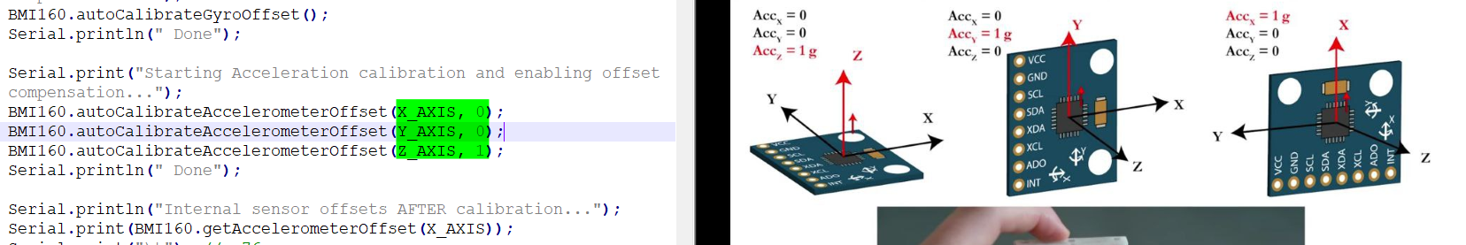

But I need to use the board with the sensor in a vertical position like this
But as soon as I turn the board on edge, the zed axis is immediately limited in movement and I get a gimbal lock.
The other axes are also nonsense, not data.
I began to look for information on how to reassign the axes, but I did not find anything - only a licensed solution from Bosch itself in the form of software.
I tried to calibrate offsets, but nothing changes after calibration - as if the axes are not calibrated at all.
I determined that when the board is parallel to the table, then the acceleration along the zed axis is about 1, along the other axes zero
When I turn the board on edge, the x-axis becomes one, the other axes are zeros.
I edited the offsets, but nothing has changed.
a: -0.19 0.06 0.97
    BMI160.autoCalibrateGyroOffset();
    BMI160.autoCalibrateAccelerometerOffset(X_AXIS, 1);
    BMI160.autoCalibrateAccelerometerOffset(Y_AXIS, 0);
    BMI160.autoCalibrateAccelerometerOffset(Z_AXIS, 0);
I can’t understand anything, the datasheet says that you can use the sensor in any orientation, but I can only receive normal data in the horizontal space of the board.

The bmi160 sensor is a pleasure to work with.
To rotate the axes, you simply indicate which axis you have facing up and put a 1 on the line.
In my case, the X axis is facing up.
If this is the Z axis, then put one(1) in the third line, and 0 in the another strings.
It is more difficult to rotate the axes of the mpu9250, lsm303dlh and l3gd20 sensors and others.
The Bosch sensor in this board is a very good sensor and the library for it is well written.
