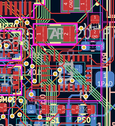

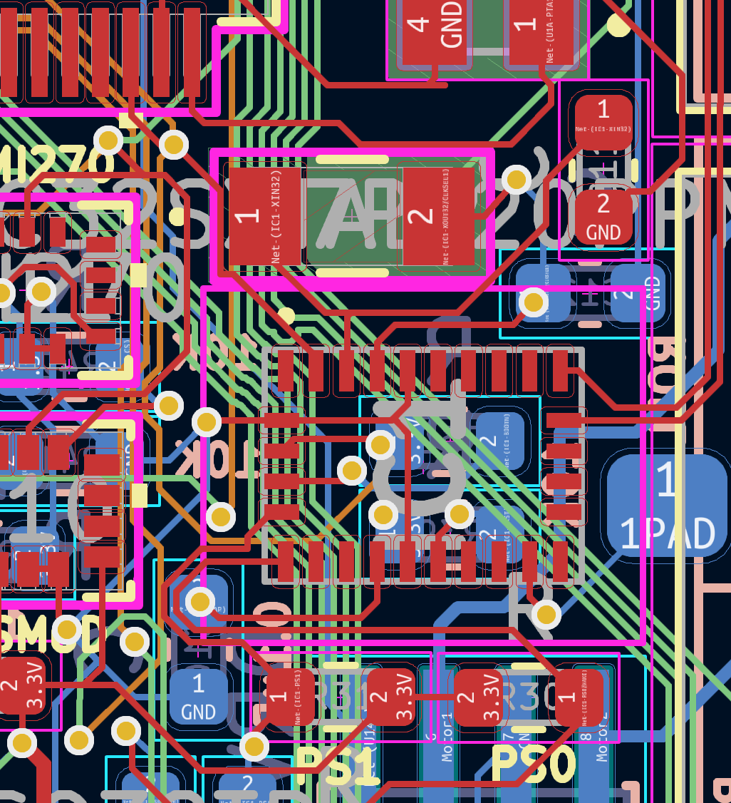

Here is the chip on the pcb layout. I have used this chip before on an older flight computer using the Adafruit breakout. This is my 3rd prototype the Teensy 3.6 is a little unstable for some reason. And yes i have tried running it with the plane code just to talk to the 085 with no luck.

I note your PCB pattern is not the full PCB.
Do you have a gnd plane or decent area that is a gnd reference?
Okay, so you need to do some breadboarding, not using your PCB to prove you have communication with the 085.
Do you know if the crystal on the 085 is oscillating, the two 22pF capacitors connected to it do not look as though they go to a gnd plane, but to gnd through some thin tracks.
The gnd connection for the 22pF caps in my mind should go to gnd pins on the 085.
So layout could be a problem.
Yup. Some kind of noise issue is likely. Taking the oscillator net through a via is not a good idea. Forking an oscillator net is also not a good idea. Having no GND plane underneath and around the oscillator is not a good idea. And that's just the situation concerning this little bit. However, even with this layout, I'd expect the BN0085 to do something.
