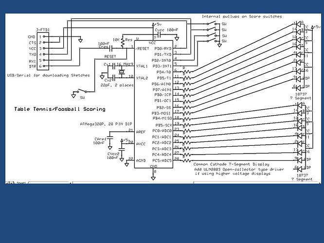

Thanks guys for all the suggestions. Basically the PCB will have a shift register and 1 Digit 7 segment LED and resistors driving the LED. Basically I am building a scoreboard for a foosball table. The LED's will be mounted on the sides to the table and I am thinking for putting the arduino under the table in the center and run cables from there to the PCB mounted on the side of the table
Kirash4, I like the idea of making a customs board to drive the LED's. So basically I can just get a atmega328 and load the boot loader to it?...Right now I have a 12v 2Amps power adapter that is providing the current to the arduino. I want to use the same adapter for the custom board aswell. How should I provide the current and voltage to the Atmega chip? Install a 2.1mm adapter to the customs board?

Yes, with a 5V regulator (7805 type) to make 5V for the atmega.
16 MHz xtal, two 22 pf caps, 10K reset resistor, 3-4 100nF caps, 14 current limit resistors for the displays, all available inexpensively from dipmicro.com
You will have 2 digits, one for each side?
7 outputs from arduino for each display, 3 buttons for score (left score up, right score up, reset).
17 total.
Leave D0,D1 free to download sketches.

Look at kingbrightusa.com , maybe get a couple of big digits! Common anode - run from 12V, add ULN2003/ULN2803 to buffer arduino output to sink current to make them light up.
I wonder, for what he's doing, is the external crystal really necessary? It's just lighting up the LEDs, displaying numbers ... not like he's doing some high speed serial, or keeping (semi accurate) time ...
I put one in everything. Price is minimal, like 31 cents, lets the board act just like an arduino when done, no fuse fooling around needed.
Foosball score schematic, direct drive of 7 Segment displays
Thanks a lot for the diagram!!...I still don't understand some stuff from it, but I will get the part first and then if I have any questions I will ask again. Really appreciate your help!!
No problem.Its just the minimal parts needed to mimic an arduino (the left side of the diagram), with some LEDs and switches connected (the right side).
