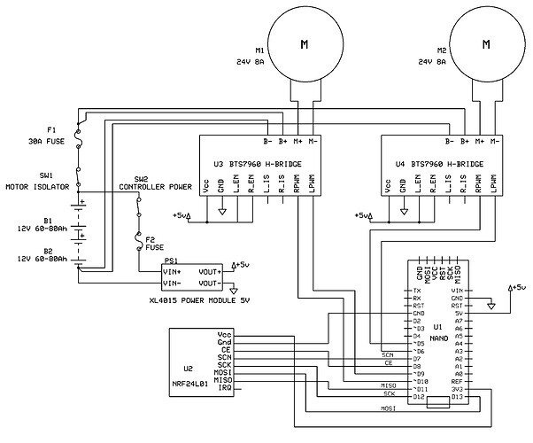

Hi Everyone!
I'm on my way to do a lawnbot using wheelchair motors. Steel frame is ready, arduino is wired but during tests I burned 2 BTS 7960 and I do not know realy why. I have a suspicion, but I'm a civil engineer, not an electric specialist, so I would like to share my problem with You.
2 arduinos connecting each other by nrf24L01. Steering is a joy with a potenciometer - working as power limiter. I have tested communication before, everything worked pretty ok. Lawnbot will be powered by 2 car batteries in series. For now, I have tested it using my laboratory power source.
First of all, I tested BTS using car bulb - it worked. After connecting wheelchair motor and a few tests (10 times forward and backward) in minimal power (2A -3A max) BTS burnout - a lot of heat from BTS without motor moving.
I have some ideas, but maybe somebody could help me before I check all of them and burn a box of BTS.
  1. Not enough power after motor starts from my laboratory power source. Not stable voltage in arduino can get errors during operations. - after using car battery or independent power source to Arduino it can be fixed?
  2. Wrong code - see below.
  3. Changing directions in motor rapidly causes cross conduction. Someone mentioned this problem here: IBT-2 H-Bridge with Arduino – Dr Rainer Hessmer : "The H-bridge does provide a delay (switch on/off delay / slew rate), which would prevent the cross-conduction issue if you could send both PWM signals at the same time. But because of the time arduino takes to process the line of code (analogWrite in this case) it will still cause cross-conduction.
    I don’t have the exact numbers anymore, but the build-in delay is about 4/6 ms (depending on resistance and temperature) and the delay time between the 2 lines of code is about 4-8 ms. This sometimes causes an overlap, resulting in crossconduction."
  4. Have to use soft start code.
I have spent a lot of time looking for solutions but still nothing.

Can you post a schematic, the frizz thing is missing a lot of details. Show all interconnections and links to the hardware items will also help a lot. Does your buck converter control the high or low side, I have seen both. Leaving pins on the 7960 bridge open is asking for problems. If you check the data sheet on the BTS7960 It has minimum voltage requirements, if you violate them that could also destroy it. Trying to suck 16 Amps from a 3A supply is like trying to empty the pacific ocean with a tablespoon. How do you know it burnt out and what part of it fried?
Where is your fuse to the motor power supply.
If you short out a car battery 100s of amps will flow and destroy any wiring/components in its path.
Can you post a link to the motor driver boards.
I notice the motors are 24V 8A, that means that from stop to run you will need to supply at least 16A per motor, as you are trying to start a stalled rotor.
For testing are you using the batteries or a lab power supply?

I have just had a close look at images of the motor drivers, have you got the motor and the powersupply connected to the correct terminals?
Look at the bottom of the PCB, I'm not sure if yours looks like this, but all circuits I see have the motor and battery/suppy pairs the other way around.

I had to get your diag into electrical symbols.
I think it gets all your connections.
Wow! :+1: Yes, this is exactly what I want in the end (+ F2 fuse that i don't have, but it is good idea).

Good Schematic! I would suggest using 10A - 12A slow fuses for the motors. A 30A will not protect the motor and probably the wiring. With a 30A you need something in the range of 10 AWG wire. 14 AWG wire is rated at 15A. These are by the US NEC, depending on length, insulation, temperature rating etc you have a large choice of wire size. This also helps in fault isolation. You can pinout R_IS and L_IS and read the current or fault condition with your meter.
