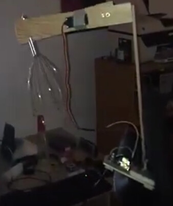

Hi Community,
i started a projekt with a servomotor to move 0 - 50 degrees and backward ( loop )

Now i want a button to start the code above. Push button one time to start and push another time to end.
I'am a very beginner and dont't know how to do it. Can someone help me?

Are you building this in a simulator or in the real world with hardware?
grafik
real :slight_smile:
You shouldn't supply the servo from the arduino.
The voltageregulator on the arduino can deliver a maximum of 500 mA. Even a small servo pulls more current at least under load and then your arduino will do a reset or the voltage-regulator gets overheated and destroyed.

The arduino reset without condensators. I installed two 100nf and it works fine.

@flashko This could work. But not with the button from the starter kit. Now i know what to do. I need a self-locking push button. Thanks for the code :slight_smile:
