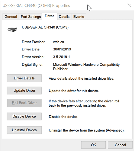

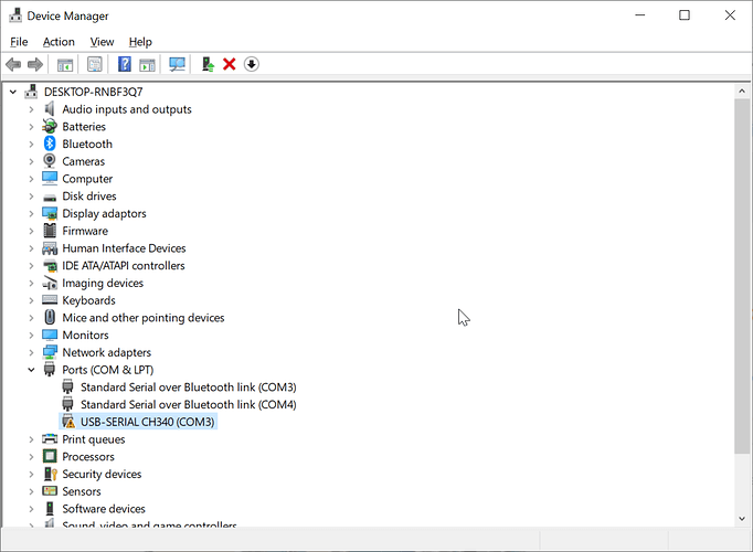

First Mac OS stopped supporting unsigned drivers, you could disable that check up to some version, same happens in latest Win 10 updates. CH340 used to work well with the Chinese drivers, but recently I got a problem in device manager (yellow warning sign). The issue wasn't resolved with reinstalling and installing the latest version of drivers. This could be resolved by booting into safe mode with the security layer disabled (it's not an option that satisfies me). Basically newest security features prevent the CH340 from working.
They used to work well in IDE with the old bootloader option. The problem is on the usb-serial level.
I got a new FTDI breakout and plan to move on to mini pro (which programs well on my system).
I'd like to make use of my old boards, instead of throwing them out and replacing by minis.
I'll be interested to see what happens with the CH340 Windows driver. Maybe the OP has got an non-signed version.
My Windows version is 10 Pro version 1809. My CH340 driver is dated 08.08.2014. version 3.4.2014.8 Provider wch.ch and is signed by Microsoft Windows Hardware Compatibility Publisher. Everything seems to work with CH340 devices.

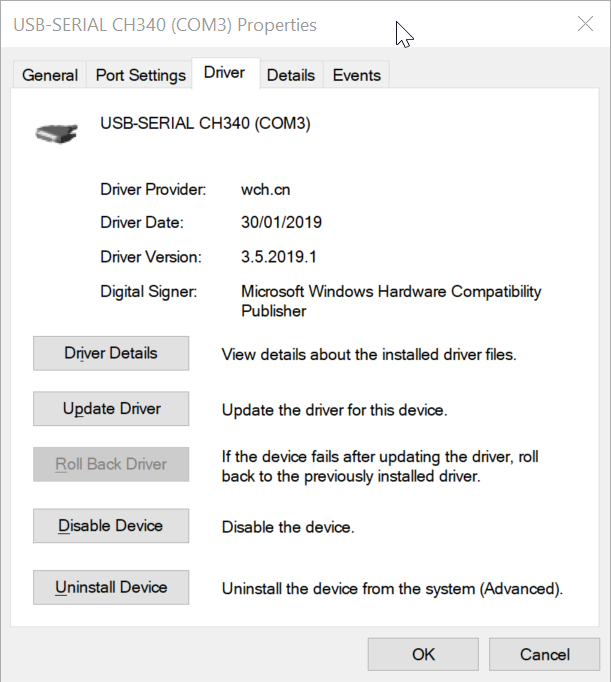

That is the driver version which is working successfully for me with
Windows 10 Home
V1903
Updated 7/8/2019
OS 18362.295
Well, I got the driver from:
These are some older screenshots, can't find my only mini-usb cable (another reason to move from nanos)
Win ver. 1903

BREAKTHROUGH
guys, I don't know what happened, but the Nanos now started working??
I've found the mini-usb cable, and wanted to take a screenshot of that driver problem. Now they show up correctly in the device manager and I've successfully uploaded sketches.
