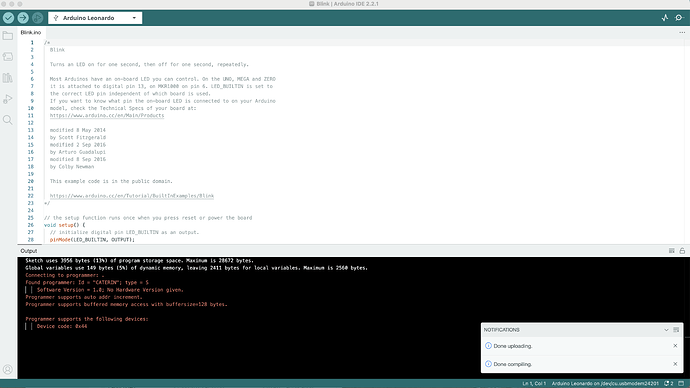

I am trying to program a sketch into Leonardo I just bought. I get this message:
Sketch uses 6994 bytes (24%) of program storage space. Maximum is 28672 bytes.
Global variables use 444 bytes (17%) of dynamic memory, leaving 2116 bytes for local variables. Maximum is 2560 bytes.
Connecting to programmer: .
Found programmer: Id = "CATERIN"; type = S
Software Version = 1.0; No Hardware Version given.
Programmer supports auto addr increment.
Programmer supports buffered memory access with buffersize=128 bytes.
Programmer supports the following devices:
Device code: 0x44
I do not know what to do from here. Any help would be appreciated.

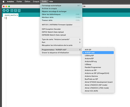

Which Arduino-IDE are you using
IDE 2.X or IDE 1.8.19?
To me this sounds like adjusted to the wrong programmer.
For Arduino-IDE 1.8.19 you should use
best regards Stefan
I am using Mac OS Version:
2.2.2-nightly-20231110
CLI Version: 0.34.0
I do not know where to choose the programmer and boot loader you suggest. I cannot find this on my Mac OS IDE.
I found and chose the AVRISP mkII programmer. I cannot find where to select a bootloader.

If I use Arduino-IDE 1.8.19 on windows I have this programmer options
Maybe user @J-M-L can chime in as an apple-expert
best regards Stefan
that sounds useful.
I'd say it looks the same but better :slight_smile:

@n7kd see Connecting to Programmer Message?
can you double check if the upload actually failed ?
What you actually get is the upload is successful but you don't see it say so on the screen where you normally would.
Instead click the notifications and you will see it says "download successful".
Had me fooled at first as well.

This is the screen shot, you get these notifications if you click the small bell in the lower right screen margin with a dot on it and the number two after it. Here it is:-
You will have to press the expand icon to see the full detail in the screen dump.
To be fair they do flash up quickly when they occur, but as a long time IDE 1.x user I was not expecting it to be there.
Note I just tried this with the settings set to :-
Show verbose output during compiled and upload.
Along with Compiler warnings set to All.
Then it behaves very much compilation on the 1.8.19 IDE.
You don't even get the found programmer bit that was so puzzling at first.
