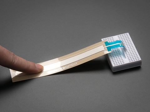

Hi all
I'm trying to design a slide pot using the capacitive sensing library but I can't figure out how to properly design the circuit schematic. Looking at the related arduino playground webpage, it is written that with just two pins and a linear resistor ladder a working slide pot can be designed. However I need help to understand how to make a worth resistor ladder and how to connect the conductive foil to the circuit. I searched long way on the web and on the forum but I didn't came to a solution. Thank you in advance!

Not easy to know about what you are talking, but if you refer to the resistive device mentioned above, add a capacitor and you'll have a variable RC circuit. Then you can use any library based on oscillations periods to determine the resistance value.
not sure what you are looking for but just connected a Microchip_2_channel_slider to ESP32 GPIO4 and GPIO15

serial monitor output as I move my finger along the slider
ESP32 Touch Test
Microchip_2_channel_slider reading GPIO4 and GPIO15
Touch: 52  47
Touch: 29  42
Touch: 28  42
Touch: 25  43
Touch: 25  43
Touch: 25  41
Touch: 27  39
Touch: 29  35
Touch: 30  34
Touch: 30  33
Touch: 32  31
Touch: 38  29
Touch: 46  26
Touch: 49  24
Touch: 49  25
