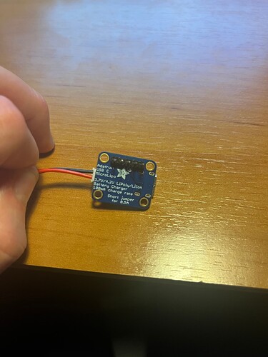

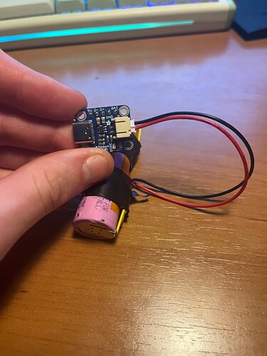

Hi I have a samsung INR18650-35E rigged up so it's output is a 2-pin JST connector. Is there a component that i could buy so that the arduino nano RP2040 can receive power from the battery with jst connection so that the compoinent is a midway component? I have tried the adafruit USB C microlipo but this only works with their own batteries and their batteries do not have enoiugh capacity

Thanks for the reply, here are a couple of photos of the components I have. I have not included the arduino nano RP2040. Yes, it is an 18650 battery. The capacity of my battery stated is 3450 mAh. What I am lookking for is a replacement for the Adafruit USB C microlipo that will be able to connect the 2-pin JST connector up to the arduino nano RP2040. I'm doing this for a school project and the arduino is controlling and recieving the data from multiple sensors.
