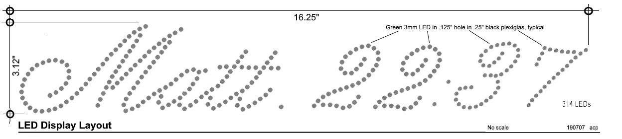

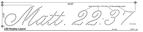

Working on a motion detector (PIR) actuated LED display
w 300 lights. Using 3 mm LED Mouser #: 604-WP710A10PGT
mounted in plexiglas operated by Maxim 7129 IC in
a custom designed PCB controlled by a Arduino Uno.

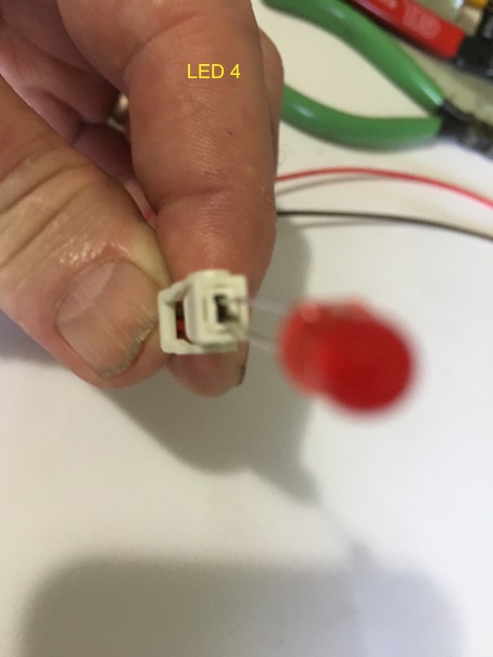

Using the VCC CNXBX4112 it is often difficult to get the
LED leads to fit down into the header. See attached photo
marked 'LED One'.
In that photo the header marked 2.2.2 sits
down properly on the LED leads. The other two headers on the
right, like many others, even after fitting and refitting for
five or ten minutes will not go down onto the LED leads.
When the leads won't go all the way down on the LED lead,
if even touched slightly, will some times disconnect.

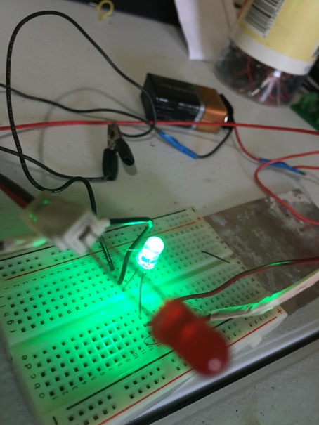

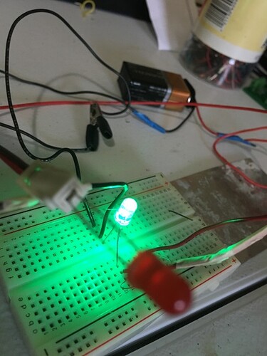

Hoped the Amphenol would solved the problem with fitting the header onto
the LED lead. But although the leads go into the header easier, the header
does not conduct through the LED to make the LED light.
See GIF marked LED Three.

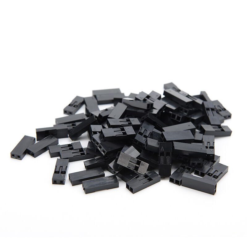

I have used "dupont" connectors for this purpose. The connection is not quite a secure as I might like, but I haven't had any problems of them coming loose yet. I would not recommend it for an application that is going to experience a lot of vibration or impact (such as in a vehicle). You should definitely cut the LED leads down so the are no longer than necessary, as this will give a bit more friction hold to the connection.
Unless you find pre-assembled 2P cables, you might discover that it takes longer to do the crimping and assembly than it would have to solder and heat shrink.
The dupont connectors are readily available for a very low price. I've always bought them on eBay so I don't know what they are called on Mouser. These are the same connectors you see on the female jumper wires commonly used in the Arduino world, except 2P instead of 1P:
