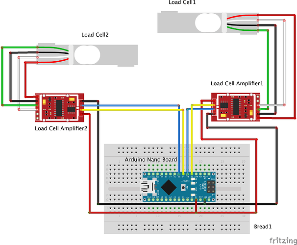

You mean like in this picture?
Yes.
The HX711 output will be the average of the two loadcells

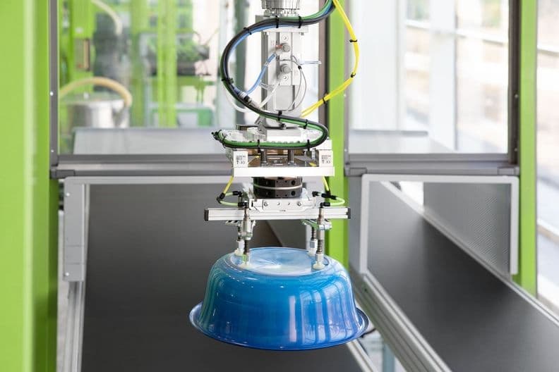

Prototype of a weighting control system (as shown in the picture).
Can't tell anything from that picture.

Use two HX711 amplifiers, one for each loadcell
You are not saving much by just using one.
