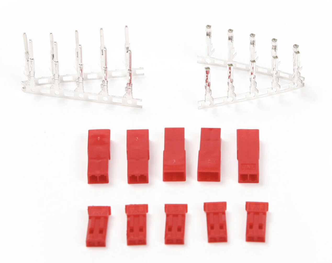

If you don’t mind crimping your own, maybe JST type connectors may be the way to go.
However, these are not chassis mounted.
you mean the dc jacks I shared?
so they are not good for the PSU power connection but I can use it for the 15 meter two conductor wires between optocoupler and mosfet board?
