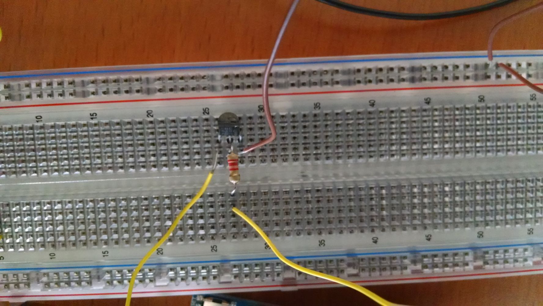

Here's the wiring with the BC547.

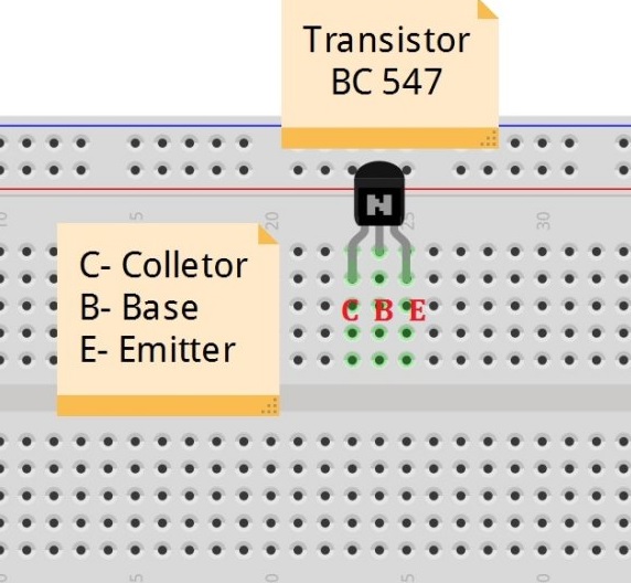

COLLECTOR on the left, to solenoid neg, EMITTER on the right to gnd, BASE in the middle.
Cannot see where you wires go, can you get arduino and solenoid closer together and in the same frame please.

It doesn't show where the wires actually go. (Tom also said this as I was typing.)
Still, assuming the left-hand wire goes to the negative side of the solenoid, the connections look fine to me. I have no idea why it won't turn off.
Wait, is that really a BC547? It looks like the label says BC548. A BC548 is only rated for an absolute maximum of 30V. A BC547 is rated for 45V, that's why I suggested it.
Is it just my eyes?
I'd say BC548 as well.

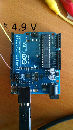

Wow, I have no idea how you guys caught that, but yes, it was a 548; I didn't realize those were also lying here. I'm impressed with your CSI magic : ) But I have replaced it now with the BC547.
And yes, as OldSteve assumed correctly, the left side yellow wire is going to the negative terminal of the solenoid, the resistor wire is going to the Arduino pin 4, and the brown wire is going to ground.
The COLLECTOR voltage relative to ground is also pretty constant at 7.1 V, even when the base voltage drops from 4.9 V to ~ 5 mV.

7.1V? And when providing 5V from the Arduino through the base resistor, the actual base of the transistor should never be at 4.9V. It shouldn't get higher than about 0.7V!
This has me bamboozled. Something simple is seriously wrong here. Something that we can't see in the pics.

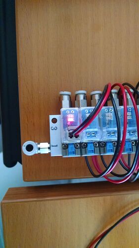

We need a photo with everything in the picture, the protoboard, the arduino and the solenoid so we can see all your wiring, also show your power supply.

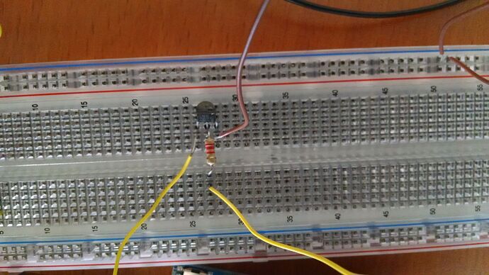

here are the photos, hopefully it is clear - let me know if anything is unclear or needs labeling. The only change from my previous comments is that I took out one of the 9v DC batteries to see if it would make a difference.
Thanks for the pictures.
If you pull the transistor out of the protoboard, and operate the circuit does the solenoid switch OFF.
If you leave the transistor in and pull out the base resistor, and operate the circuit does the solenoid switch OFF.
Does your DMM have a DIODE test function?
Thanks. Tom... :slight_smile:
