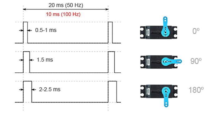

Thanks for the response. If possible, can you elaborate further on the 1st paragraph? Is it that a digital servo can receive shorter length pulses compared to an analog servo? or that if one were to send the same signal length to both an analog and digital servo, the digital servo would somehow output shorter pulses like the image below and move faster?

standard-servo signal is a short pulse every 20 milliseconds.
the "faster" -servo signal is a short pulse
where the short pusle has the exact same length as the standard-servo-signal
but the short pulse is not repeated every 20 milliseocnds but repeated every 10 milliseconds
best regards Stefan
Hi, sure. The Difference between Analog and Digital RC Servos - (radiocontrolinfo.com)
The diagram in post #5 shows the pulses used to control the motor, not the control signal to the servo input.
Analog servos use a lower drive frequency than digital servos.

The signal from the controller to the servo, signals the angle required of the arm.
The servo internally, reads this angle, then compares it to the angle that the servo is presently at.
The servo position is read from a potentiometer connected to the servo shaft.
The internal controller in the servo then determines how to move the motor, clockwise or anticlockwise, depending on the two values.
The digital reference is to the internal servo controller and how it processes the two inputs and makes the output to the motor.
Thank you for the detailed explanation!. To confirm my earlier confusion, the control signal sent to both an analog and digital servo would be the same. The difference between them would lie in how the digital servo processes this control signal into high frequency pulse width cycles that seem to be commonly >300Hz
No. The wire connected to the microcontroller send one and the same signal to analog and to digital servos.

For feeding in a signal into a servo you always use the same standard-servo-signal.
As long as you don't need real high performance where high perfomance means servo horn has to reach its endposition within 0,1 seconds instead of 0,3 seconds the standard-servosignal is absolutely sufficient.
