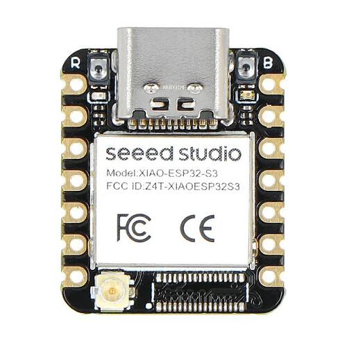

What works for sure is a ESP32-nodeMCU-board
looks like this
But there is even a smaller Board with an ESP32
Seeeduino XIAO ESP32-S3
You have to make sure that it is a S3
not a C3
C3 is a completely and rather new microcontroller which means a lot of code does not yet work
I haven't tested a XIAO ESP32-S3 yet.
But I'm pretty sure that they work the same way as ESP32-nodeMCU
