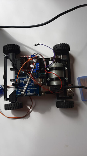

Hi everybody, this is my first post on this forum. I am working on my first Arduino project where i want to control a ''RC'' car with a PS4 controller(very original I know). I am using an L298N H-bridge to control the speed of my motor with a PWM signal. However the problem I run into is that the speed seems to be either 100% or 0%. I have a feeling that it is because my Arduino is sending a new PWM signal to the H-bridge every time a signal comes in from the PS4controller, which makes the PWM signal start over at a very high frequency resulting in a 100% duty cycle. I have no clue how to fix this and am frankly not even sure if this is the problem. Any help/ advice would be greatly appreciated. I have pasted my code and a picture of the robot below:
