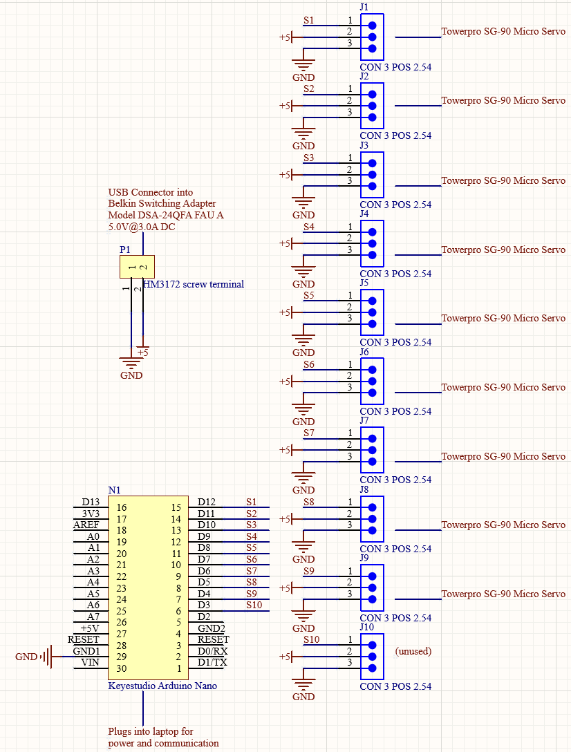

Hi all,
I'm building a project that features 9 servos, with a maximum practical current of roughly 3.5A, running via an Arduino nano. I've got the servos powered off their own power supply, but whenever the Arduino turns off while the servos have power, they tend to jump (I assume the board outputs some noise on the digital pins whenever it loses power).
My solution to this was going to be to use a transistor (I was thinking of a TIP122) to control current flow to the servos, so that I can essentially have a 'halt' pin on my board.
The problem is, I've sent myself down several rabbit holes trying to figure out the right transistor to use, what resistor to put on the base, etc. etc. Before I lose any more of my mind, I want to know: is it even worth trying to use a transistor? Should I use a relay instead? Is there another type of transistor I should use? Is there a whole different solution to the problem with the servos jumping?
Thanks, and let me know if you need any more information.

I see several possibilities, follow TomGeorge's request and post an annotated schematic. I and many others do not do well with frizzies. When posting the schematic note any wires over 10" / 25 cm in length.

I've attached a screenshot of the schematic in circuitmaker for simplicity's sake.
This is what I have currently:

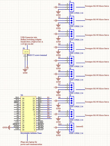

and this is the proposed change:
in this configuration I would drive HLT low whenever i wanted to disable the servos.

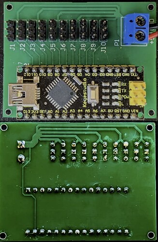

Also, a photo of the PCB that I have currently.
I see a collector of a NPN tied to GND. That's confusing to see.
If you drive the base low, you drive it low compared to what? Compared to the emitter is what I know, but do you have a defined voltage level at the emitter side?
Sorry, the way I've set the schematic out is very confusing. I really should clean it up.
In this case the GND symbol really just connects to the servo grounds. I wasn't really sure how to represent a screw terminal supplying power in circuitmaker, and the transistor was added hastily for this post, so it doesn't really fit terribly well. In reality, the emitter of the TIP122 is going to the scree terminal, which represents actual ground.
