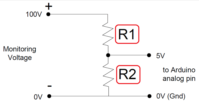

"Grounded A0" means the input of the current sensor not connected. "The 2.48 V" comes from ACS712 properties. When there is no connection, ACS712 output gives 2.5, but for mine, it gives 2.48.
Here schmatic is attached.
yes, but my sensor idles at 2.48.
The MAIN PROBLEM THAT I AM ASKING is voltage read calculation.
I have searched and tried a lot of things but I could not measure voltage. I measure only btw. 2.48 and 2.55.
I am measuring current right, but I cannot measure voltage. The main problem is this.
thanks. I will try your code as soon as possible and notify you.
The current sensor does not give you a voltage reading of the supply. The current sensor gives a voltage proportional to the current passing through the module. A formula is done to get the I.
You can measure V by putting the Vin ( on a Uno <5V) onto A1 and measuring it there.
V and I readings are done separetly with different components and different functions.

https://solarduino.com/how-to-measure-dc-voltage-with-arduino/#:~:text=Arduino%20has%20the%20ability%20to%20measure%20voltage%20using,of%204.9mV%20per%20unit%20(5.00V%20%2F%201024%20units).

however, if you require milliamp measurement with two or three places of decimals a better measurement device is required
I did use a ACS712 some years ago to measure the current taken by an extruder ram - when the current reached a set level (indicating ram was reaching the end of the extruder) the ram would be stopped and withdrawn - however, the current measured was several amps and great accuracy was not required
