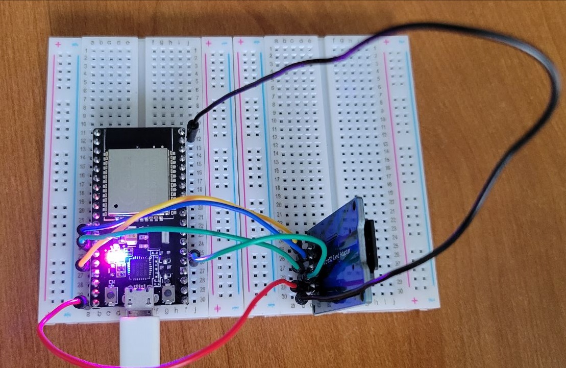

I am trying to replicate the following project but I'm having trouble talking to the SD card.
Writing the provided compiled code the Tiny Basic works and I am able to read and write to the SD card. So I know the hardware works and it is possible.
But the code for setting custom pin settings I keep finding doesn't seem to work. The pin configurations don't match HSPI or VSPI. Some posts imply either will work but other posts say HSPI and VSPI use specific pins, neither of which correspond to this setup.
If I understood one post correctly, I can use any pins I want but the frequency would be limited to up to 40 MHz.
I am able to get the blue built-in light to light up just like the Tiny Basic version does but it is always telling me "SD Initialization failed!" and the card is unrecognized. Also, when I do this, the serial communication stops working.
Any idea what I might be missing?

#define SD_CS_PIN        13
#define SD_CLK_PIN       14
#define SD_MOSI_PIN      12
#define SD_MISO_PIN       2
#define MHz 1000000
  Serial.println("Serial communication started.");
  pinMode(SD_CS_PIN, OUTPUT); // SS
  //SPI.end(); - doesn't seem to do anything
  SPIClass spiSD = SPIClass(HSPI); // Neither HSPI nor VSPI seem to work
  spiSD.begin(SD_CLK_PIN, SD_MISO_PIN, SD_MOSI_PIN, SD_CS_PIN);
  if (!SD.begin(SD_CS_PIN, spiSD))//, 1 * MHz)) - no freq work: 1, 25, 40, 50, 80 MHz
      Serial.println("SD Initialization failed!");
  uint8_t cardType = SD.cardType();

Why not use the natural SPI pins of an ESP32? Does your library do software SPI, which is much slower?
By declaring your SPI object and instantiating in setup() the created SPI object losses its scope. C Variable Scope (w3schools.in)
I already have the hardware and it is using the pins that the original author chose. I'm new to Arudino and all this stuff. This is my learning project. I think I would have done it differently myself. I will probably make my own board later that makes better use of the things I've learned.
I'm just declaring that stuff in setup now just to get something (anything) working. I will shuffle all that stuff around later.
I've learned a lot from this project and even though using these pins isn't ideal, I want to take advantage of this problem to gain more understanding.
As it does work with the TinyBasic version, any idea on what I need to do to get it to work?

Sadly, using the same code except my pin numbers, it doesn't work. It doesn't even light the blue onboard light.
Using a new ESP board not attached to my existing circuit board and using the VSPI pins specified by KeeYees diagram (CS=5, CLK=18, MOSI=23, MISO=19), not surprisingly it works.
With that same new ESP board using your (@khoih-prog) pins (CS=15, CLK=14, MOSI=13, MISO=12) and HSPI, it works.
Using the pins specified by my circuit board (CS=13, CLK=14, MOSI=12, MISO=2) and doing HSPI and
SPIClass SPI2(HSPI);
SPI2.begin(SD_CS_PIN, SD_MISO_PIN, SD_MOSI_PIN, SD_CS_PIN);
if (!SD.begin(SD_CS_PIN, SPI2))
... it ... worked! ... nnnnnkay.
So I could have a problem with:
  • the circuit board I've been using
  • maybe the FabGl library is interfering in some way (even thought TinyBasic used it)
  • a defect in that ESP board
The copy of that board running TinyBasic works. I checked my connections but maybe I missed something. Or ... something is amiss somewhere.
At least I have something to go on.
SD Card Type: SDSC
SD Card Size: 1886MB
:face_exhaling: Back to testing ... When I find the real cause I'll be sure to post it.
Thanks
