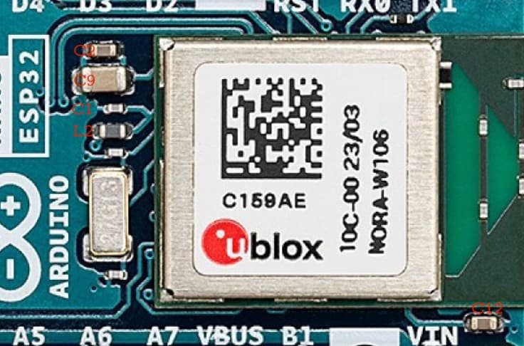

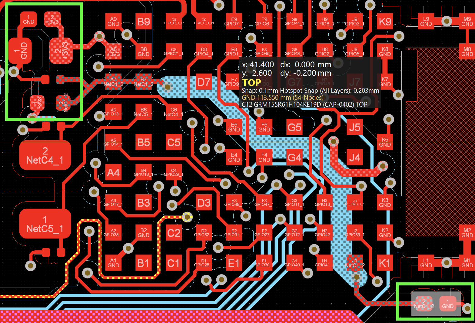

Your comment motivated me to cross-check, and these are the indicated components.
It appears that the C12 100nF capacitor is deliberately placed near the VDD_SPI pin (which is on the other side), whil L2+C1 are placed near the VCCIO pins, so in this case it seems that whoever designed this believed that an LC filter can in this case both supress high+low frequency noise and provide votlage stability at the same time.
Now upon closer inspection I noticed that C9 is actually placed closer to the VCC pin (unlike in the schematic) while the 100nF C2 cap is connected in parallel to it, again an unconventional choice but in this case I don't think it matters since both are very close to the VCC pin.
Now looking at the PCB I can see even more strange choices, such as the filtered VCCIO rail being a nice thick trace on the bottom layer (indicated in cyan), but when they connect the 3.3V rail to the pins they use thin traces which are suitable for signals but seems like a strange choice for a power rail, especially given there is quite enough space for a thick trace here.
