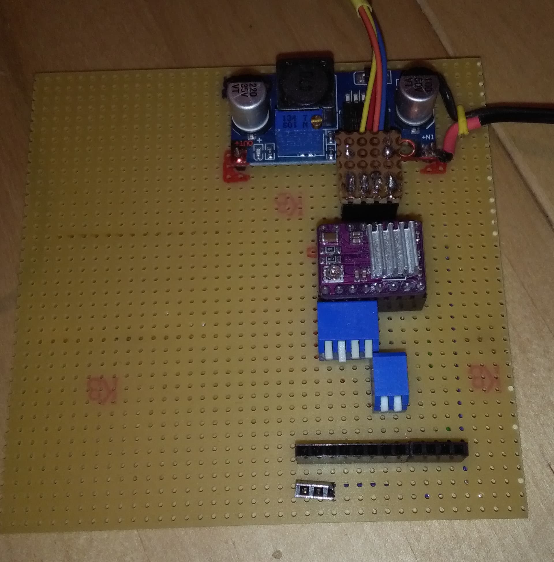

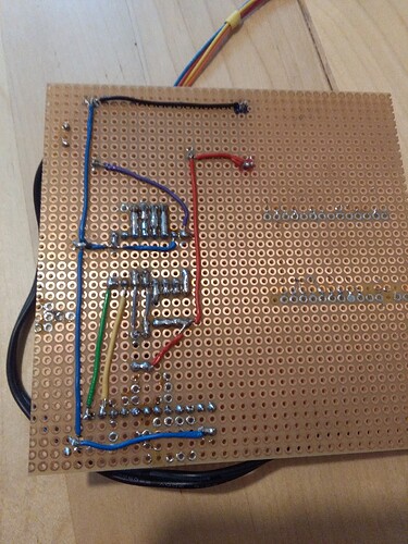

The most important question is:
How many PCBs do you want to manufacture within the next 2 - 5 years?
And how complex will the electronic be that you build?
For a few environmental measurings temperature, humidity, etc.
I would recommend using such PCBs and handsoldering
Only if you want to build at least 4 to 10 identical PCBs I would use "professional" PCBs
and then use such a manufacturing service.
best regards Stefan
