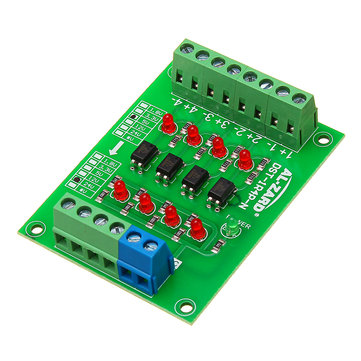

I guess I could use something like this then?

Link corrected (and also, it was a mobile link,not a proper one!): 5v to 24v 4 channel optocoupler isolation board isolated module plc signal level voltage converter board 4bit Sale - Banggood.com-arrival notice-arrival notice
That particular opto board is to use a 5 V (Arduino, DC) device to switch a 24 V DC input to some other system. That does not sound like what you actually wanted to do. :astonished:
No you are right, it's the opposite I want. Something like this then ?
Yes, that looks right.
